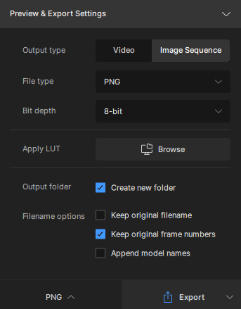

I just open my videos in VLC, step through the frames to the one I want and take a snapshot. I don’t think TVAI has a snapshot function, though I guess you could select a really thin slice of a video, export as frames and then use the one you want.

This is how you get a lot of frames. I think the original question was how to extract one.
I only want 1 frame!
Correct. Only 1 frame.

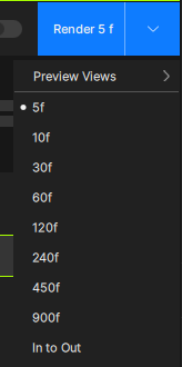

Oh, you can set it to preview 5 frames, then just grab one of them.
With some more effort, you could modify the preview command to only do one frame—but you’d have to do that every time. It’d be faster to just grab one of the five.

You said I could get 5 frames where do I set that value? I don’t see that in the export settings.

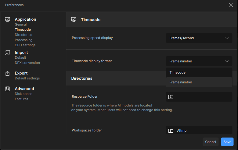

It’s not a video editor. Just an enhancer. You have to set timecode to frame number:
Then you can pick it in the preview button menu:
You might also have luck with the ‘in to out’ option.
