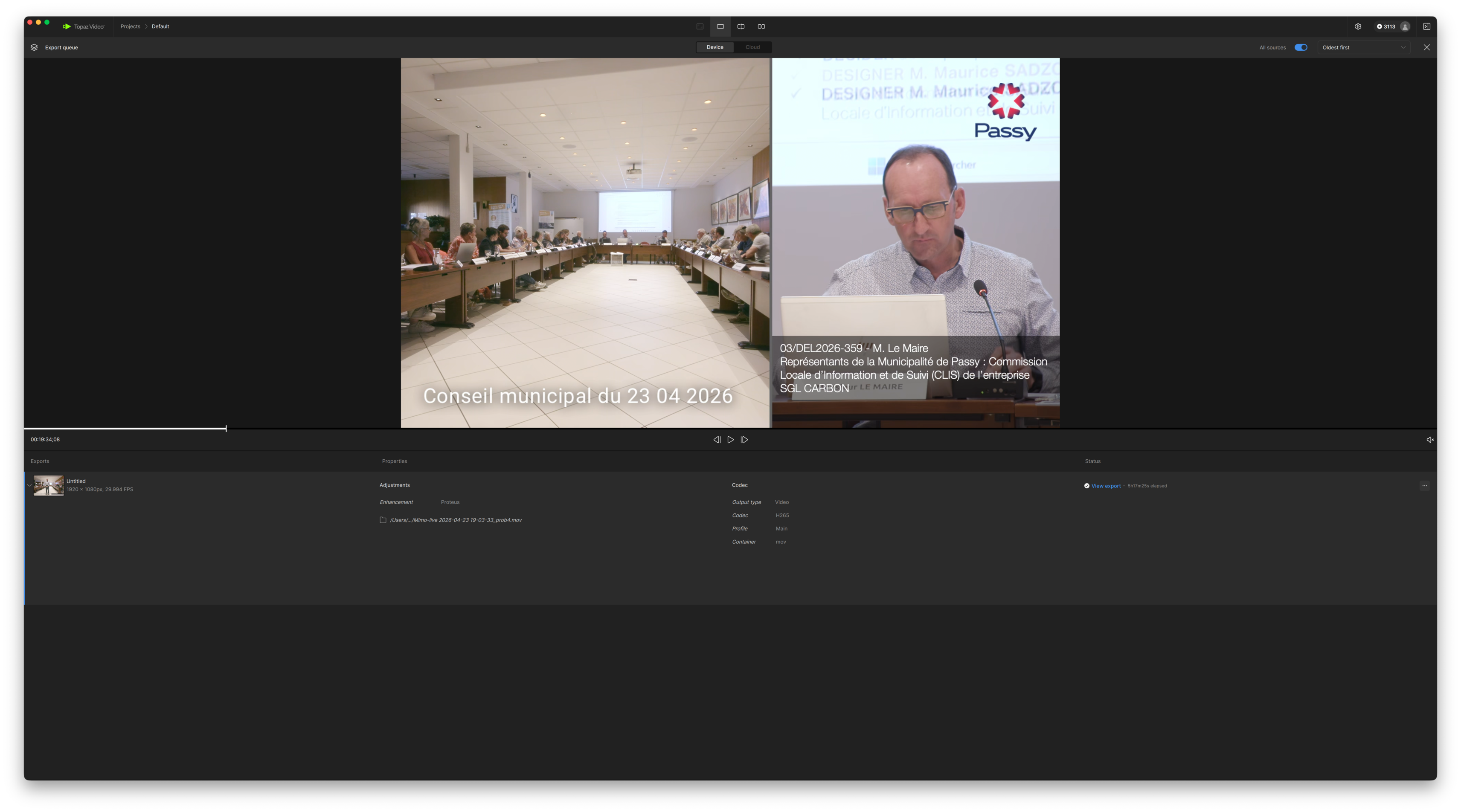

Since I switched from a MacPro 2019 to a Mac Studio M2 Ultra, my exports to ProRes and H265 crash. At the end of the calculation (Proteus and Iris, the two I use), the video systematically stops at 2.15 GB. The original files are between 2h and 3h in 1080p.
Exporting in H264, it works properly on the other hand.
On the other hand, he is not in the file I indicated to him but in the original one.
