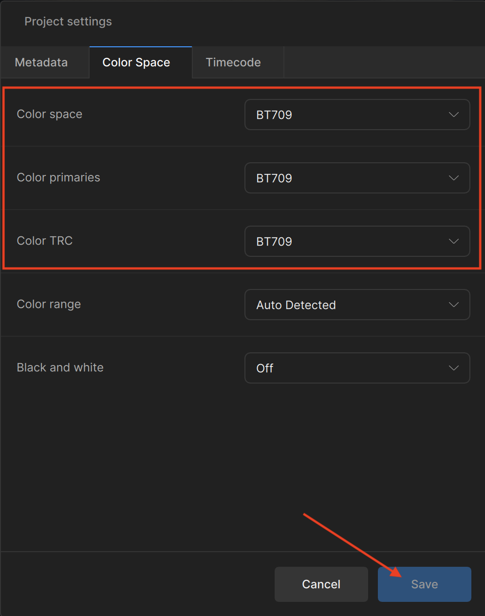

It looks like this is caused by the input file missing color metadata tags, which are causing an issue with decoding the file. Our team is looking into seeing if they can still pass the file through without that info and we have an open report.

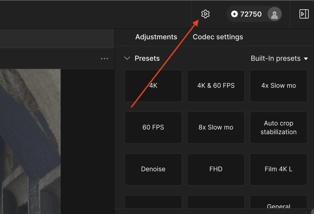

  1. Select the project settings button in the top right corner of the app:
2. Go to the color space tab and select BT709 for all 3 color dropdowns
Note: if you have set in/out points on the timeline, it will not run, you will need to export the full file or trim the video before bringing it into Topaz Video.
