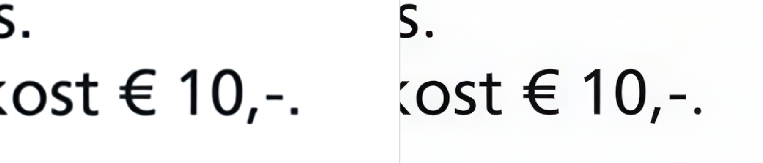

Only now noticing Denoise MAX and Wonder have a tendency to round of the dots on any text, even ones that have square dots.
EDIT: This is at lower DPI/res, it doesn’t do it if the DPI is high enough. And Text preservation does not really help with it either.

There is no compression going on, these are scanned at high resolution, then downsized, saved as PNG. ( Mostly trying to find a way to get better denoising, at the higher dpi ti doesnt work as well, the problem here is mostly the low resolution obviously makes it impossible for the models to know what font is used.)

Its not compression its the interpolation from downsizing and descreening. The png is saved at highest setting in photoshop.

I think there is a misunderstanding here, its not the aliasing that is the problem, its the fact the upscaler ( wonder does it too yes) and max denoise turn square/reactangular dots on the i/j and periods at the end of sentences into rounded ones. Even with MAX Denoise I have no issues with how it handles text otherwise.
I see! I’ve added this as a Feature Request for the ability to preserve this type of detail when upscaling, such as keeping the period square rather than having the model interpret it as aliasing and turn it into a rounded dot.
You can add your vote to the request as well. The development team reviews the most popular requests when considering future implementations.
More broadly, the request would be for a way to tell the Upscale models to preserve certain characteristics of text rather than reconstructing them differently.
Both Wonder and Denoise Max are generative models, so they can reconstruct details rather than strictly preserve the original pixels. Wonder could be a good model to test for this particular case. Denoise Max would not really be the correct enhancement for this issue, since the problem isn’t noise. You can still use it if you find that it helps your workflow.
Thanks for helping clarify exactly what you’d like the model to preserve!
