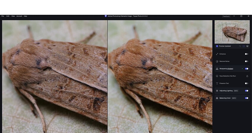

The balance color and lighting don’t work very well. Does anyone else feel like this? Maybe at 20 opacity. Why does it have to rerender every single process when I zoom out
Sorry I meant Lighting Adjustment rather than Balance Colour. Most of my shots have been of moths early morning using an LED light panel set a 6000 kelvin and Lighting Adjustment tend to result the green cast. That said I’ve just used it on one of the photos from this morning and the result is pretty good. First time I’ve seen that. Perhaps its the green background.
The sharpening and noise reduction rarely needs any adjustments and if they do its usually because the software has been unable to fully detect the subject.

Yes, I was responding to what Lighting was doing to your image. Based on your snip above.
But what I was saying was that it looked as though PAI applied a Color Balance, rather than a Lighting alteration, even though you didn’t have the Color Balance option turned on… :slightly_smiling_face: In other words, for that example it looks like the wrong feature kicked in.
I tried the Balance Color feature and was able to make the photo slightly cooler. The background was improved, unfortunately, the subject turned blue including the face. Maybe you could add the option to mask the subject to exclude from the temperature adjustment.
Can you upload the original image file? I’d like to try and reproduce this.
