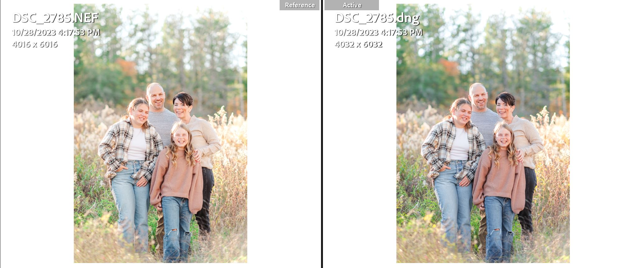

The left image is the original, and the right is after upscale in art mode - same result with gamma correction on or off.
In a recent previous post someone mentioned they fixed by changing to JPEG and altering the output mode. I found that works with jpegs.
However my image must be PDF as it is transparent. The color output controls only pop up with jpg images.
Clearly, retaining precise color is very important. Any suggestions?
