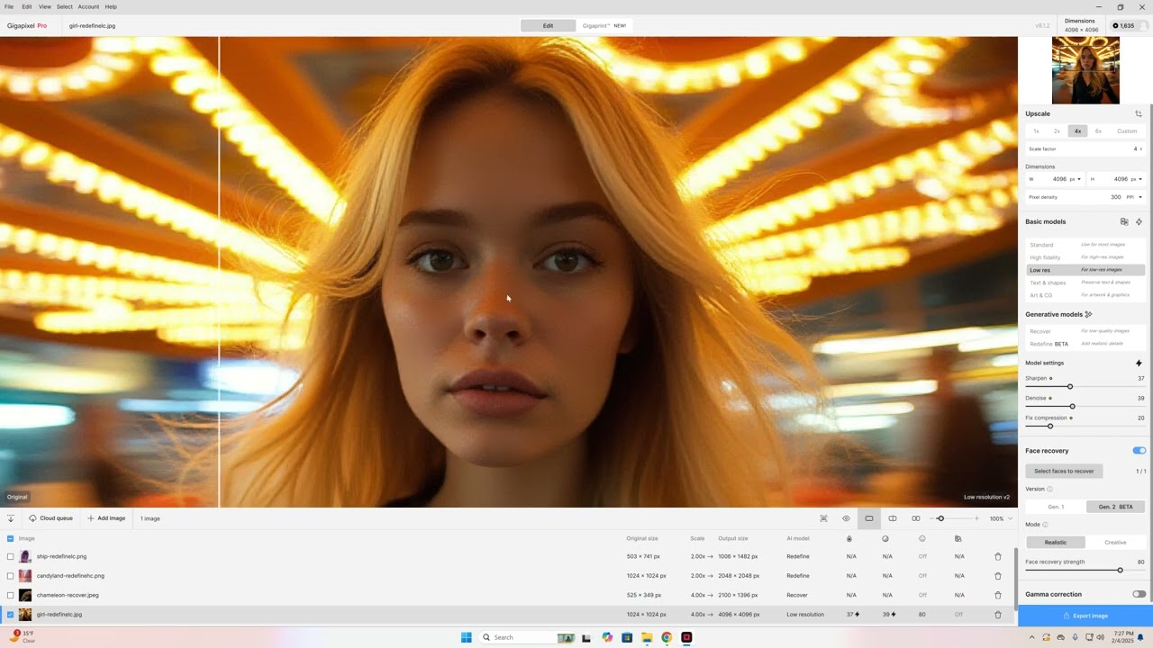

Hello.
I’m using Gigapixel 8.3.1 at the moment.
I use a lower specification laptop and get around the long processing times when using the Generative models by downsizing a picture first and then using Redefine or Recover. It’s a lot quicker and if the result is good I then Export, Save and Close the picture and then open the saved picture and then use Gigapixel to upscale it. I’ve had good results working on downsized pictures and video captures of 500px high or less.
Regards Bob.

There’s another little time saver if your using Redefine. Don’t use the Extra Sharpness and Extra Denoise in Redefine. Leave it until you have re-loaded the picture back into Gigapixel to Upscale it.
