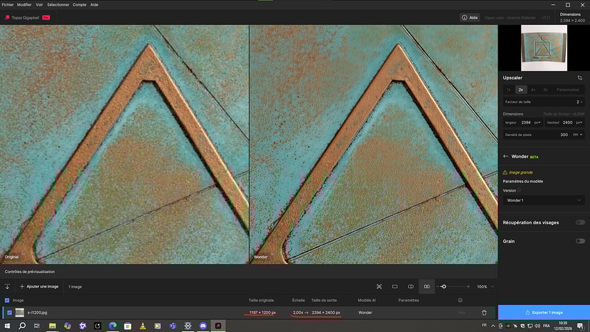

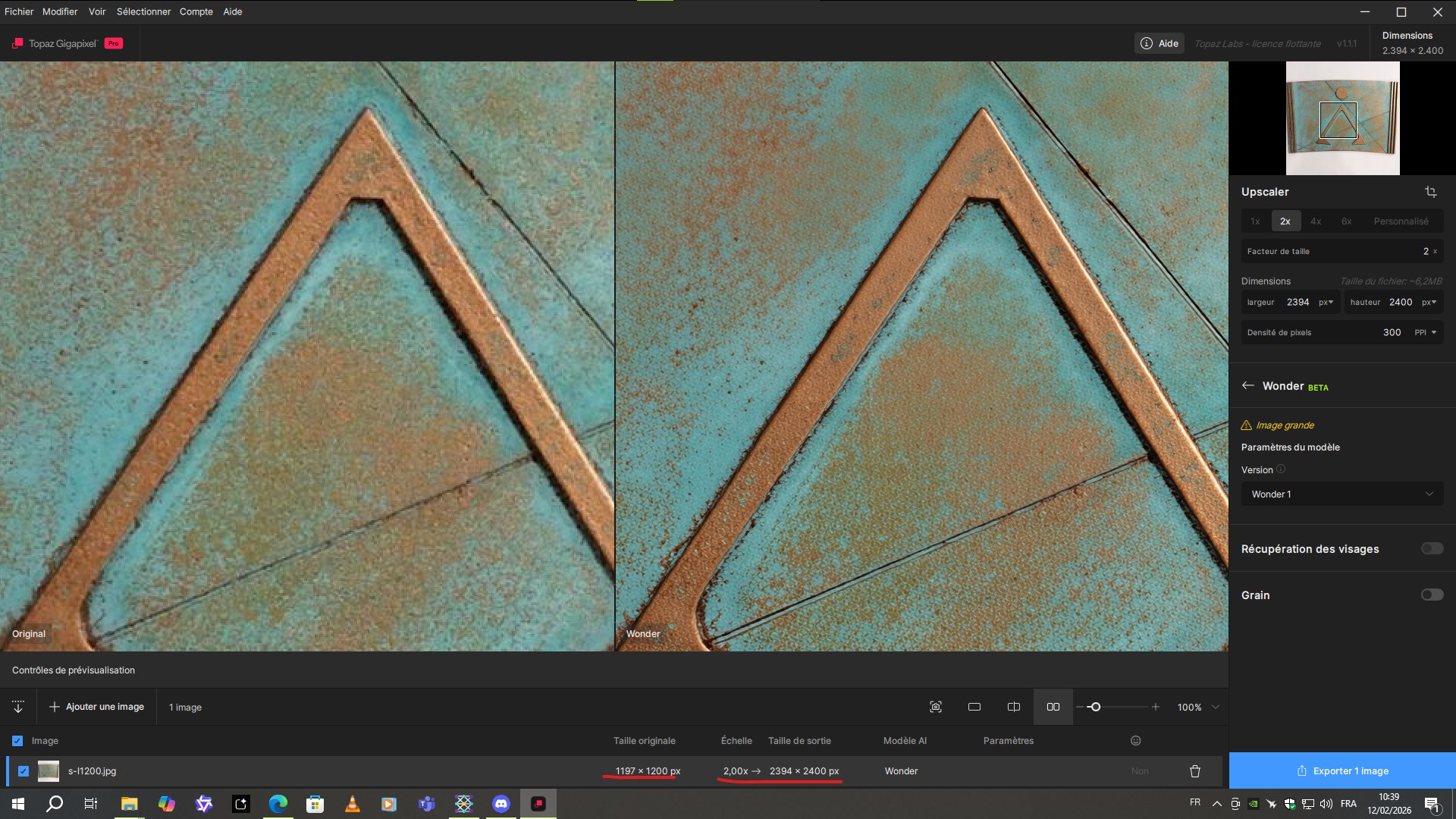

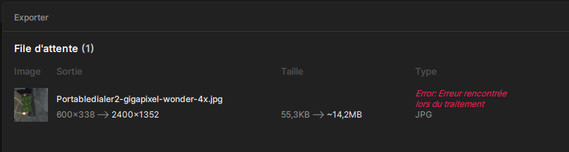

Wonder v1 seems to be broken on my machine. I can’t render anything. The render bar stops about a third of the way through and then nothing happens. And when I try to preview again, the render stops after about a quarter of a second.
My input image was 600x338 pixels
And this is what I get if I try to export directly.

Because it doesn’t work at all with Wonder 1. But it does work in Topaz Photo. I wanted to increase the longest edge to 8160 pixels.

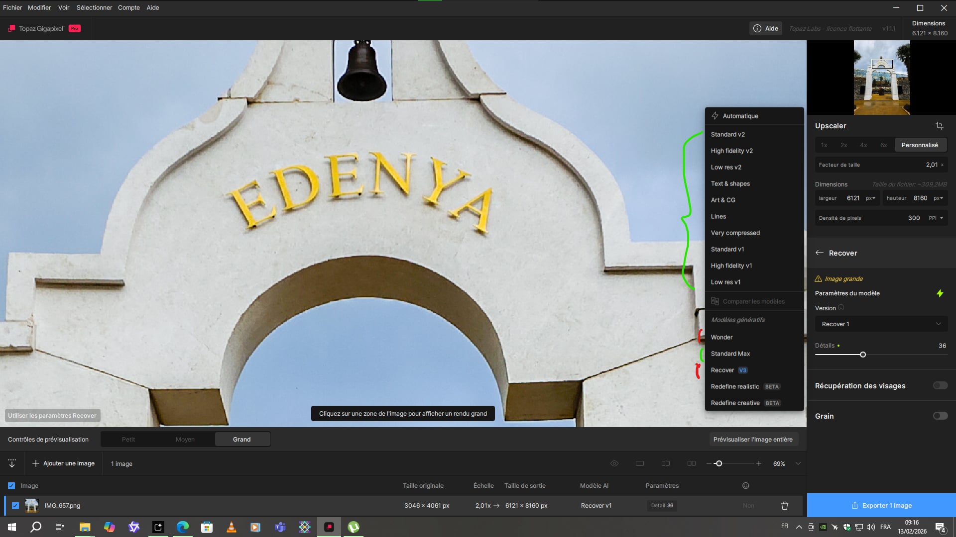

Ok the models highlighted in green work on this photo. Those in red don’t. I haven’t tested the last two because I don’t need to use Redefine on this type of image. I would like to be able to use Wonder and Recover on this one because when I preview small sections, the quality is much better than with non-generative models.
Finally, I performed another test. Instead of setting a specific value for the longest edge, I applied a resolution factor of x3. And this worked perfectly for both Recover V2 and Wonder V1. It’s still strange that it doesn’t use a specific value for the longest or shortest edge. However, the rendering took much longer, only to then reduce it in Photoshop to 8160 pixels on the longest edge.
ok, now I get it, this is probably related to an issue we have with some images that will fail if the value of the scale is not a round number. We are working on a fix for this.

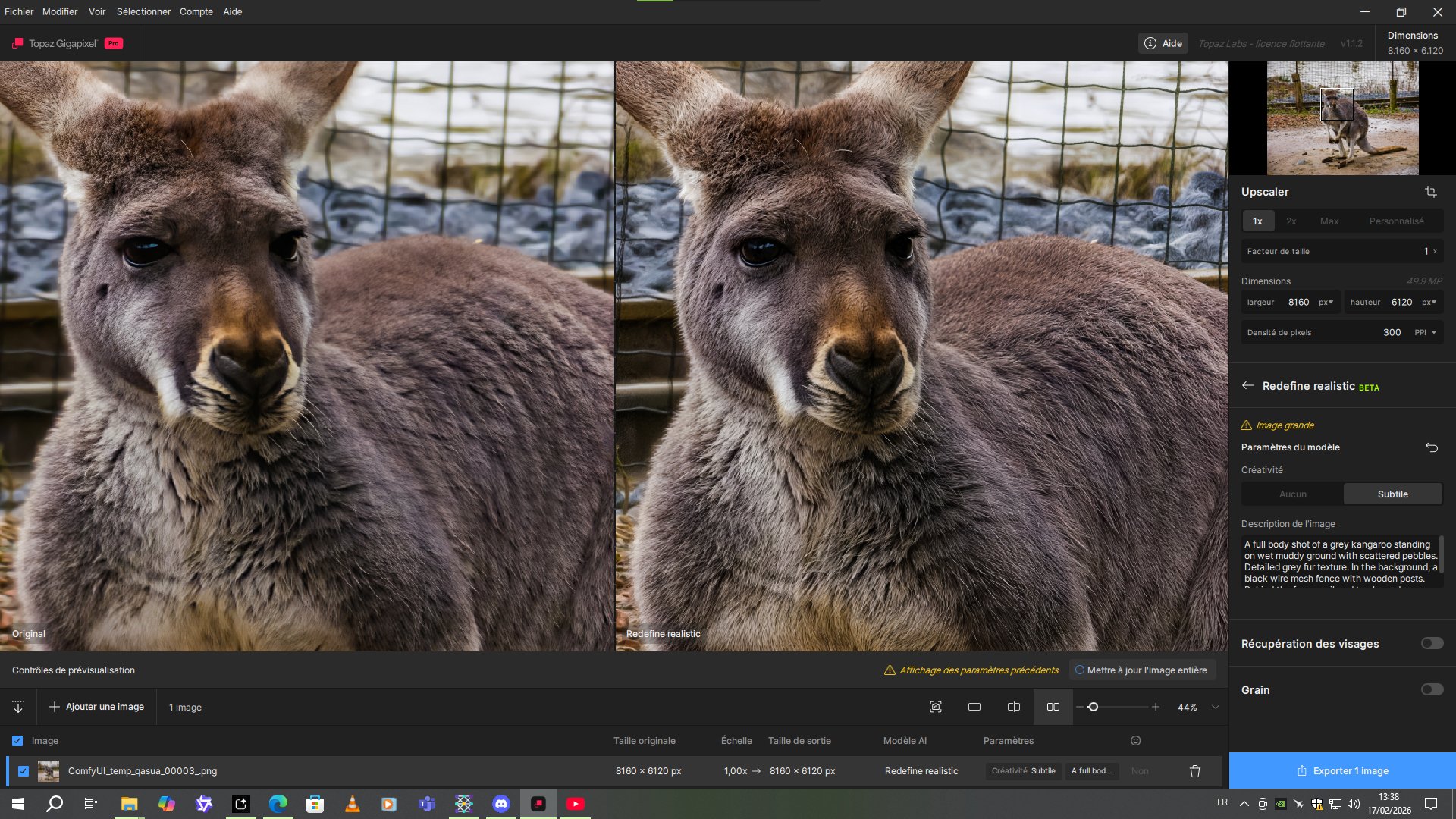

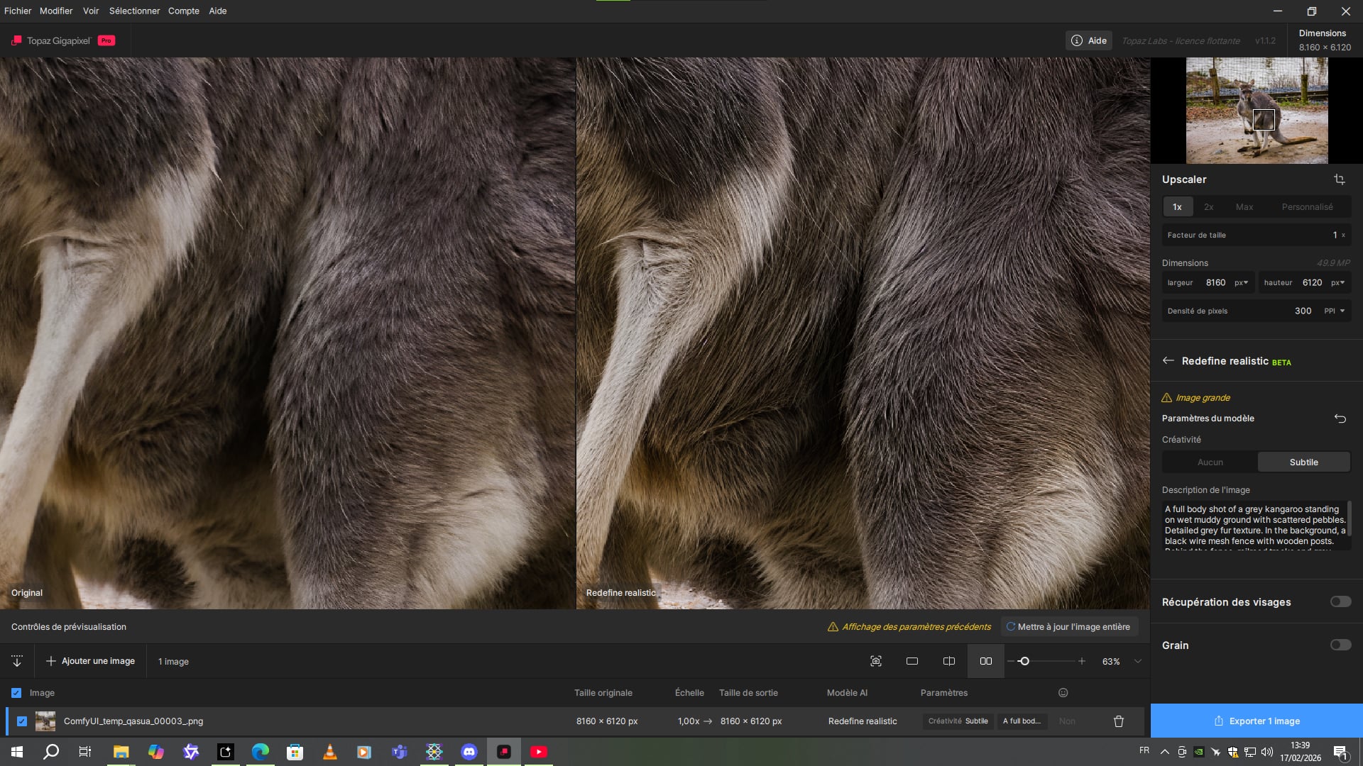

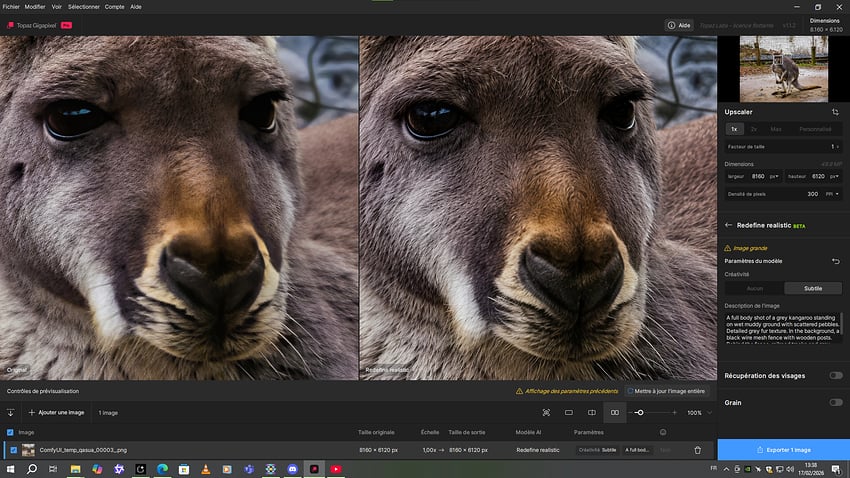

Note that I am able to improve 50 megapixel photos (8160x6120) from my smartphone to a quality virtually identical to the output of a good SLR camera with the subtle Redefine model. At x1 speed, rendering takes approximately 13 to 15 minutes on my RTX 3070.
Here’s an example with some very nice details:
I like how he improved the details of the fur.
I’ll test it and let you know if it works.
