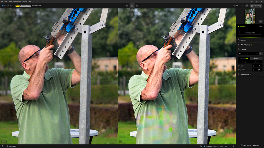

There is a severe bug in the image processing pipeline when batch processing Nikon NEF files.
When applying mild RAW Denoise in combination with the standard Denoise filter, Topaz introduces heavy rainbow/chroma color artifacts and horizontal banding on fine fabric textures (like a polo shirt). Additionally, a distinct square tiling/grid pattern is visible on the fabric (suggesting a blending issue between image processing tiles).
The community has reported similar color band artifacts since April 2023 (e.g., thread “Artifact on color band after denoise” in Photo AI Bugs and Issues). While the legacy DeNoise AI handled these patterns correctly, Photo AI still fails here.
Exact Settings Used (applied globally to the full image, using the ‘All’ selection):
RAW Denoise:
Normal, Strength 20, Minor deblur 10
  • Denoise: Normal, Strength 10, Original detail 0
  • Adjust Lighting: Model V3, Exposure -0.17, Highlight -0.17, Shadow -0.34
  • Sharpen: Standard, Strength 22, Opacity 44
Changing the secondary Denoise model to MAX eliminates the color artifacts, but local processing speed becomes unworkably slow (even on high-end hardware like an AMD Ryzen 9 9950 X3D and NVIDIA RTX 5080 system). Disabling the second Denoise layer removes the artifact, but for batch workflows (>500 images), manual intervention or per-photo mask adjustments are not viable.
Screenshot:

Thanks for the clarification regarding RAW Denoise vs. standard Denoise on well-lit images. I understand that applying standard Denoise on a low-ISO photo is technically redundant.
However, I still want to point out a fundamental issue with how the algorithm behaves in these scenarios:
  1. Artifacts vs. Overprocessing: Unnecessary noise reduction should at most result in a softer or over-smoothed image. It should never generate rainbow/chroma color artifacts or grid-like banding across fine textures.
  2. Tile-Blending Issue: The distinct block pattern strongly suggests a tiling/patch-based processing issue where the AI fails to properly blend overlapping boundaries on repetitive patterns (like fabric piqué).
Even if an enhancement isn’t strictly necessary, applying it should not cause mathematical rendering errors or blocky artifacts in the image pipeline.
I will stick to using solely RAW Denoise for this batch to move forward, but I wanted to share this insight so your dev team can look into the tile-blending behavior on fine textures.
[Perhaps I’m a bit overly critical, but in the end, we both benefit from a flawless and reliable tool!]
