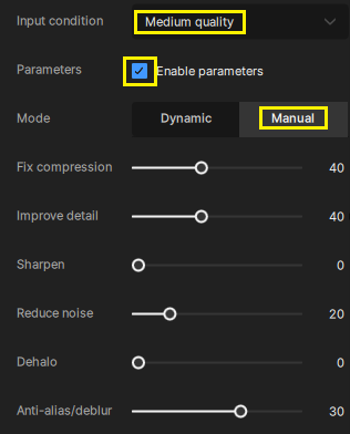

Lately I found by using Iris MQ (x1 / Original resolution) with the following settings to be very efficient denoising AI, removing noise from my HQ/HD content with much much less details loss then what I am getting with Nyx (all variants of Nyx and number of settings I’ve tried).
For both cases (bellow) I left the Recover Detail (ROD) at it’s default value of “20”
For Medium+ noise level source (Manual mode)
Fix compression = 40
Improve Detail = 30
Sharpen = 0
Denoise = 40
Dehalo = 0
Deblur = 30
For light/moderate noise level source (Manual mode)
Improve Detail = 40
Sharpen = 0
Denoise = 20
Dehalo = 0
Deblur = 30 (=50 sometimes provide better crisp picture, but higher risk of fine objects distortion, such as clothing, tank top strap/lace, etc.)
