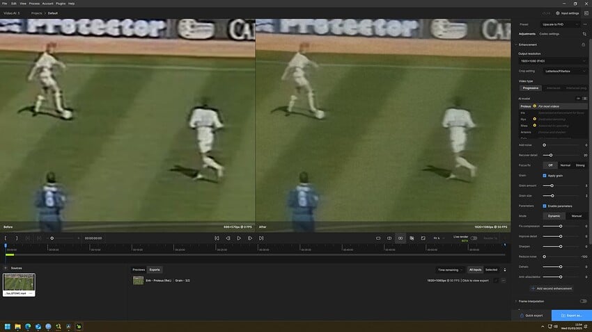

Yes Dehalo does generally blur everything, another reason not to add denoising in the mix. It’s targeting is very hit and miss. Here’s an example somebody was asking about recently:
You can see in this instance the dark edges are visibly reduced but the image is overall softer as well. It seems to give better results for the dark halo than it does for light halo and I usually end up using Hybrid for light halo first then Topaz to deal with the darker side of the edges. It’s not ideal and I have to resharpen after with an edge detect mask to prevent it putting back what I removed but it’s the best I can do. As I said I’d rather not add the denoising into the mix which just removes even more detail but right now there’s no other option. It’s also reducing contrast which doesn’t help the rest of the picture.
