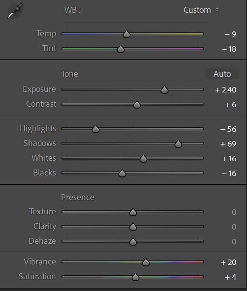

LR Adjustments
Nikon D750, Nikon 24-70mm f/2.8, SS 1/200, ISO 500, f/8.0
Top Image: Original RAW image - as I look closer at this file, I can see some of the magenta.
Middle: LR adjustments
Bottom: Shows magenta areas in jeans, especially in the black shirts - after processing thru Denoise AI.
Well it is a way underexposed image. Your pushing the boundaries, use Edit in from LR with it’s adjustments and send a TIFF to DeNoise.
Yes - it is underexposed. Indoors, mixed lighting, only able to use OCF on bracket (no light stands for safety reasons or would have used Godox strobes), trying to freeze actions of dancers (1/200), use an aperture that would provide for focus of dancers and residents (f/8.0) while keeping the ISO low (ISO 500) to reduce noise. I have primes with f/1.4 and f/1.8 but needed the zoom functions. Any suggestions on settings that would have worked better?
