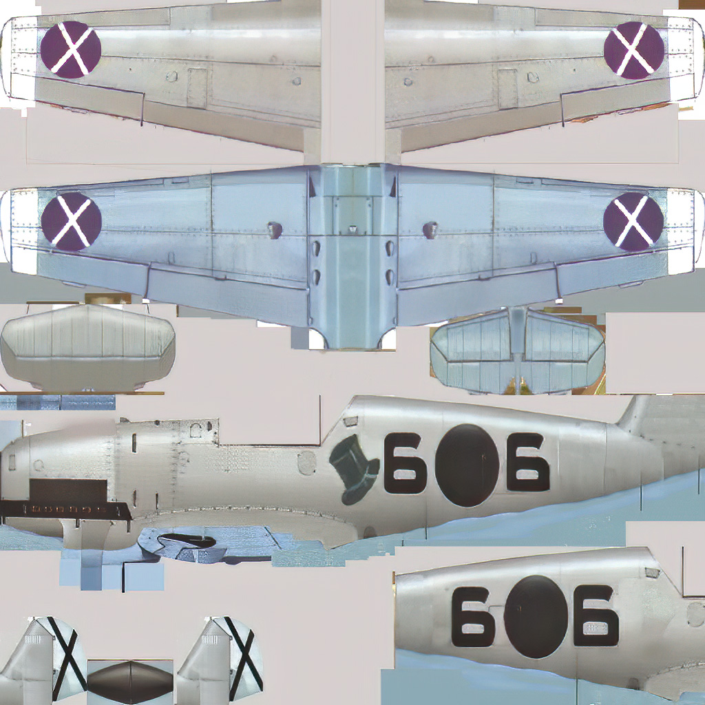

I just noticed that using the GPU (RTX2070 Super) with 2.2.7 was producing inconsistent results. Some of the uniformly noisy image (1024x1024) was being denoised, but most of it was not. None of it was being cleaned up as well as the preview. I tried it as both a TIF and JPG file; in Photoshop and as a stand alone all with the same results each time. On a whim I tried it using the CPU and sure enough it works perfectly. I haven’t really used DeNoise AI since updating from 2.2.5, but I’ve never seen it do this in any of the previous versions.
Application & Version: Topaz DeNoise AI Version 2.2.7
Graphics Hardware: GeForce RTX 2070 SUPER/PCIe/SSE2
OpenGL Driver: 3.3.0 NVIDIA 451.85
CPU RAM: 16312 MB
Video RAM: 8192 MB
Preview Limit: 8000 Pixels
Original
CPU Processed
GPU Processed
Yes, auto update is on.
I have also tried it with auto update preview off and manually pressing preview.
Both methods work fine with AI Sharpen but do nothing in DeNoise. I will grab some logs for you after work tomorrow.
Interesting. The GPU not only doesn’t remove a lot of the noise, it actually does remove some small details, and also adds artifacts on some of the edges.

Yeah, the CPU output is great for sure, the GPU not so much.
