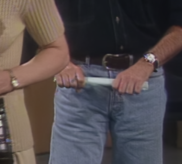

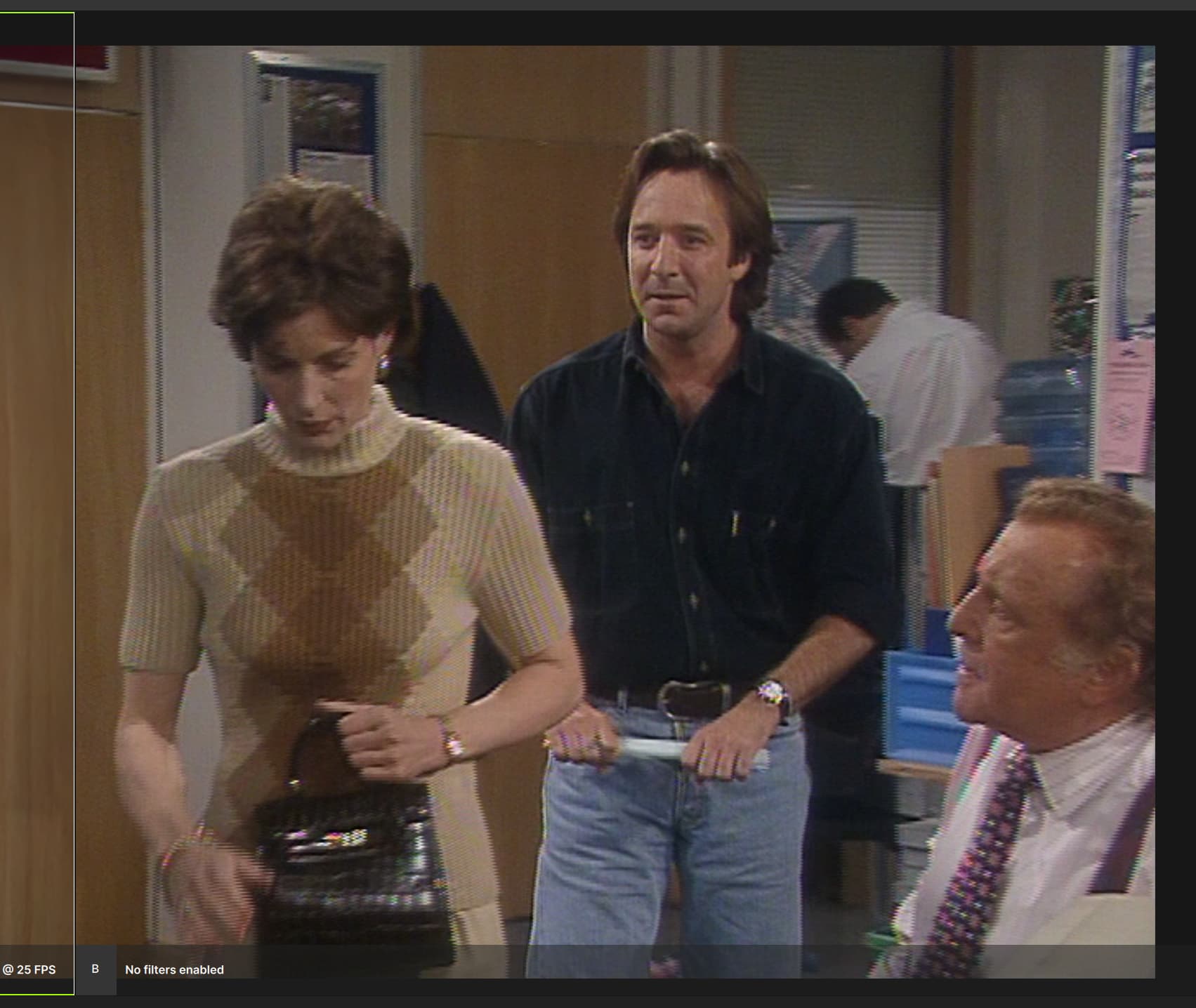

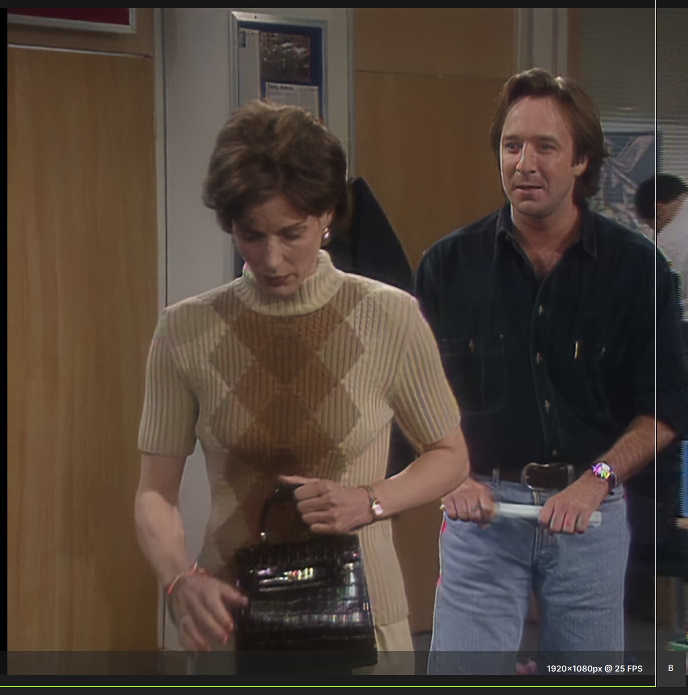

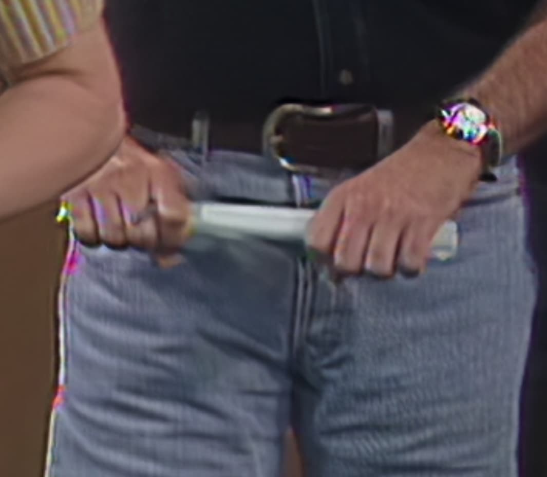

I am de-interlacing and upscaling some PAL 90’s TV shows and getting odd colours introduced (especially purple) that are not present in the original.
Granted the lighting is poor and there is often the odd (colour) reflection it is usually brief and not as noticeable as in the de-interlaced and upscaled version.
I have tried all models (Dione TV / DV, Proteus etc.) and all give similar results.

I’ve tried all the models and they all introduce the artefacts.
The only thing that helps is to increase the framerate to 50fps, which reduces it though it is still there a little.
I guess there must be some of these artefacts in the source and the AI is increasing them, giving them more prominence when there are fewer frames…
1st of all it is not deinterlacing that causes the color shift. Topaz doesn’t do any deinterlacing. the deinterlacing is done by ffmpeg Bwdif filter that VAI calls. what causes the color shift is the Topaz AI modules.
Try deinterlacing your videos in Hybrid 1st, then process the video in TVAI and see if it makes any difference.
