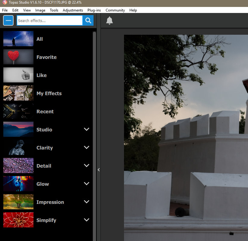

Hi, If you click on the button with 3 bars above you should get the following panel, depending on the adjustments you have, on the left side where you can select the category you want. Note that the Public icon you see on the left turns on/off the display of the public effects in the community.
You can also try Help → Check for Adjustment Updates to see if it needs synchronising. If all else fails raise a technical support request at the studio link on the header.
It does seem unusual though that you only have Adjustments & Help active though.
Here is what I get when I click on the 3 bars. The only thing available to me under “Help” is “Get Support”. So I should go ahead and open a “technical support request” then?
Yes do that, something is wrong and you may have to completely uninstall… including deleting the LocalAppData directory before doing a reinstall.
