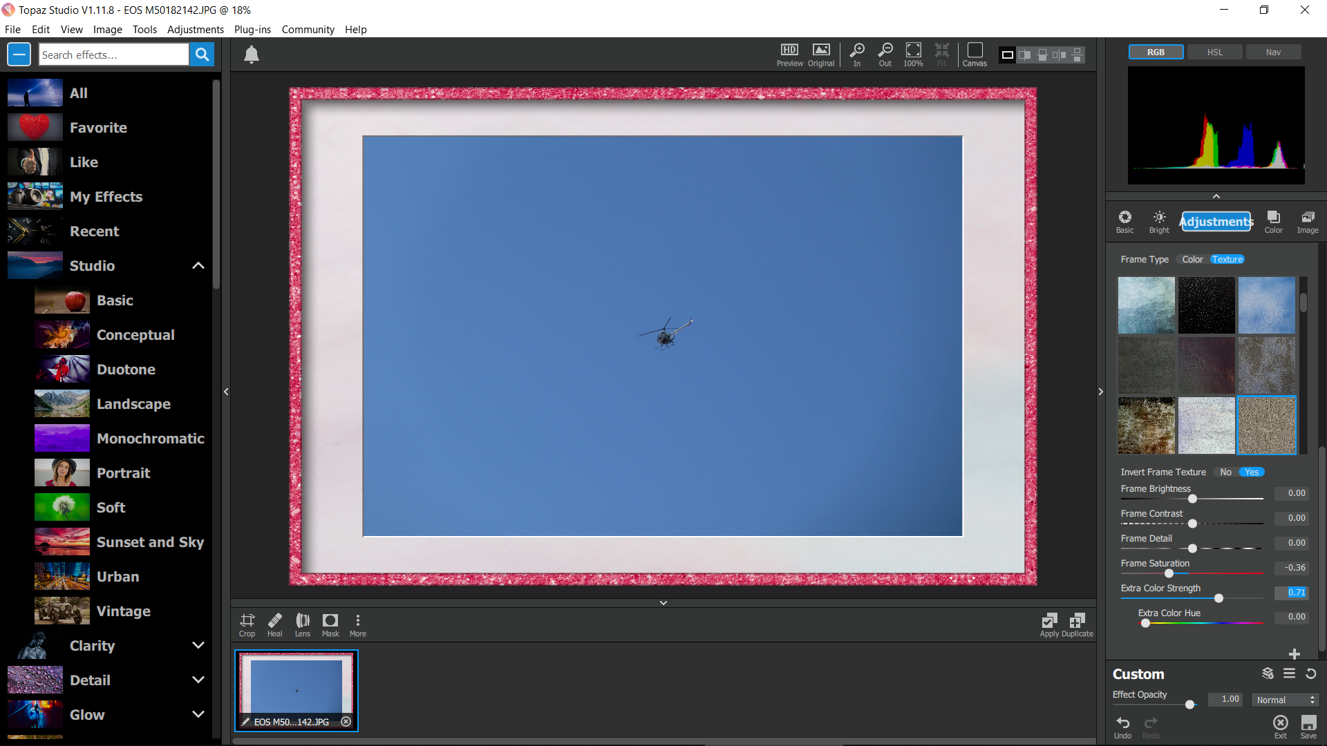

Try opening Frame and selecting “Invert Frame Texture” and the various Hue & Saturation controls on the panel … in this case it was a grey/brown frame used:

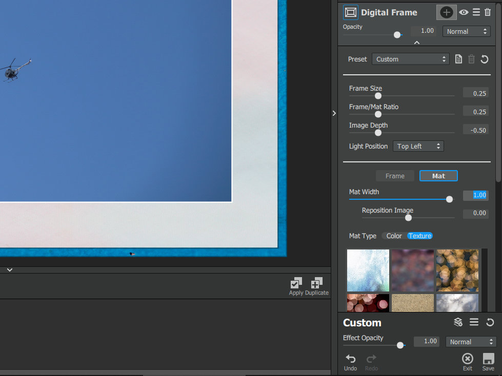

Nice images, but I wish Topaz would fix the matt so it could be equal all the way around without having to crop non-square photos.
Select Mat and then set Mat Width to 1 …
It crops the image, Don. Not something I want for most cases, it’s why I rarely use it.
Understand you are looking for something to fit an image to the frame … i.e. resize the image into the frame when it is set to even on the top, bottom & left, right … put a request in as it shouldn’t be that difficult to resize the image equally.
Resizing the canvas would be more difficult.
Hmm, not really, Don. I want the image left well alone once I have finished editing it, crop size and all. The frame should fit around the image not the image to the frame - Photoshop Canvas does this well with definable widths on all four sides. If I took a picture to be framed by a professional framer this is exactly what I would expect to see.

Using Digital Frames with other than a square crop results in either unequal sides or equal sides that crop the original image. They are aware of this deficiency back at the Topaz Factory and I hope one day to see it addressed.
Resizing the canvas is difficult except in Pixel based editors that place the image on a canvas such as Photoshop. By resizing the canvas you are resizing the image.

A very beautiful capture! I was going to suggest the same thing (Invert) that Don made in his comment.
I have used this method to change the color of a frame. I also found that making adjustments to the brightness and contrast sliders will provide different color variations too.
