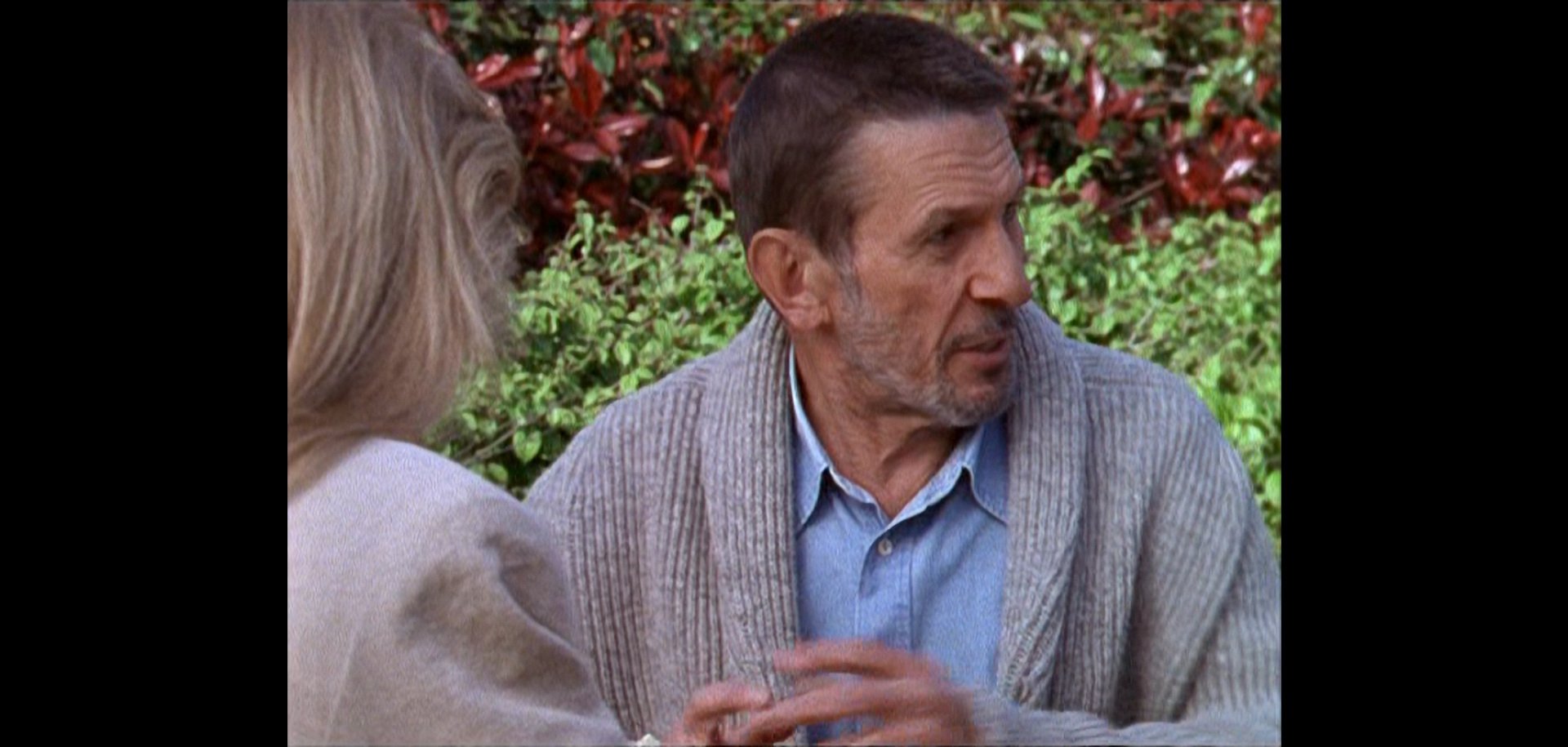

This is the original frame:
This is enhanced with Dione Interlaced Robust v4:

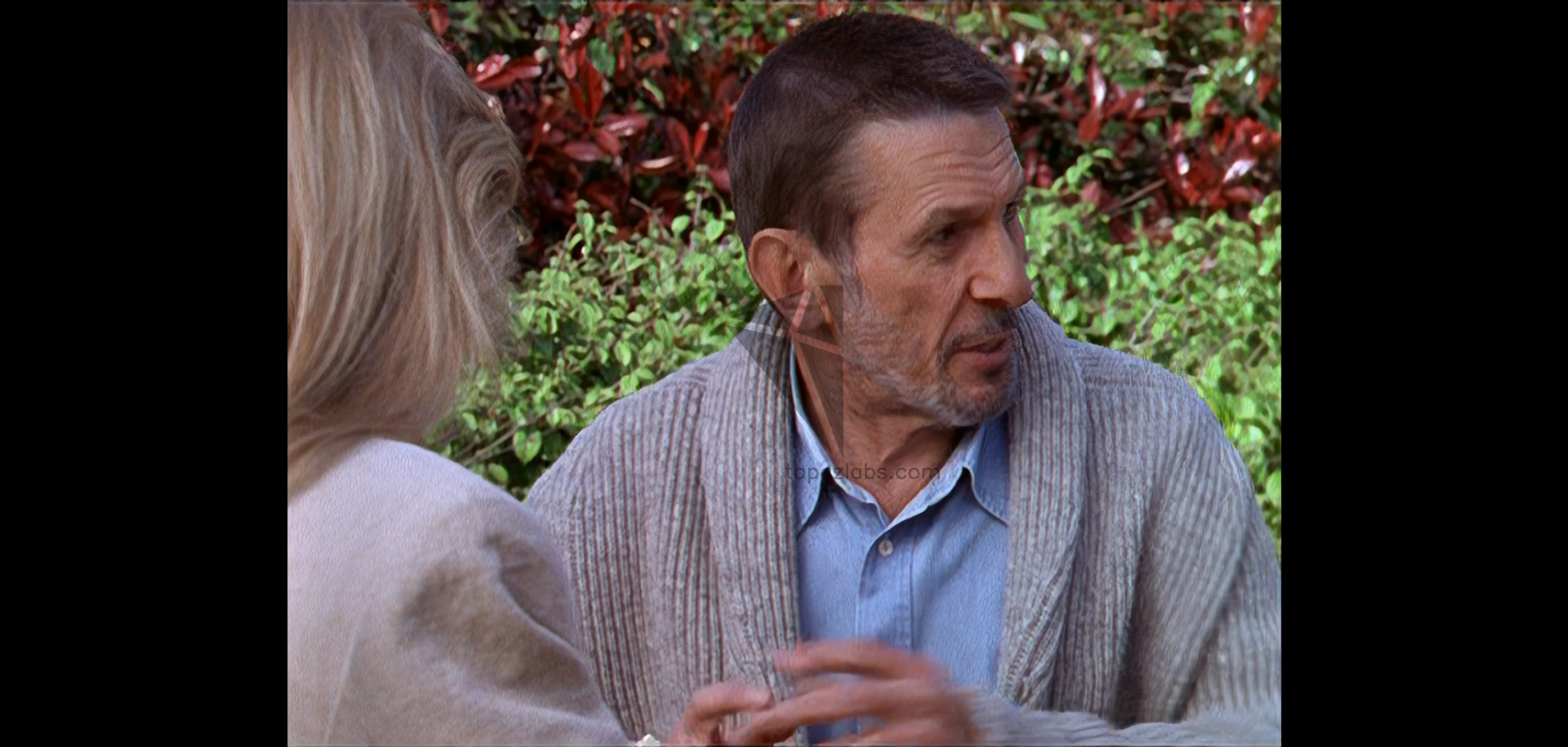

This is enhanced with Artemis Medium Quality v13:
(looks like people have plastic faces…
- The differences can be seen better if you save the images and switch directly from one to the other.
