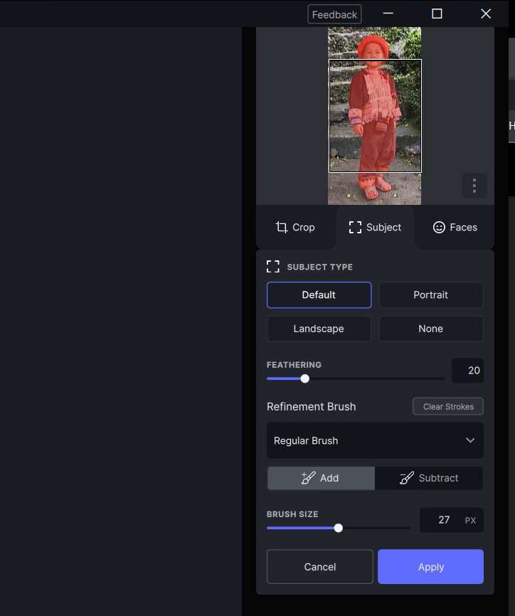

I still do not see the brushes? There is a tab for sharpening but not sharpening subject? Sharpening has a few options but no brushes? Please advise, tks
I’m using version 1.4.3. This is all I see on the right side:
What am I doing wrong?
I think your Autopilot settings need to be changed. You have probably got subject detection set to None. It needs to be one of the other settings.
Ok, that helped. I see the brushes now. Thanks for helping.
You’re welcome!
Clicking on Subject in the app means you can activate subject detection for the image and access the masking tools from there …
I can see the brushes now. When I go to edit, there is a blue mask over the subject and I cannot see to edit. How can I turn off the mask and make adjustments?

You can hit “subtract” and remove parts of the mask you don’t want.
