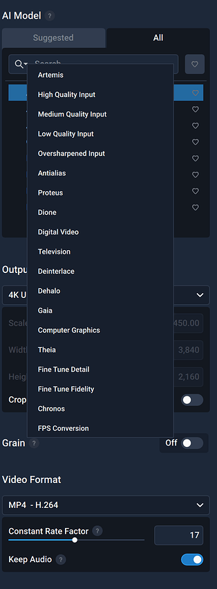

Thanks johnnystar. I’m unable to select “Gaia” or “Theia”. They appear in the list, but when I choose either of them, the only option that then appears is “Artemis”. But I’ve been getting very good results with Artemis. Tried Proteus as well and got good results too although it’s hard to know which settings are best with that choice. Haven’t tried QTGMC yet. Is it Mac compatible? I’m on an iMac 2014 with 4GB GPU card.

I don’t use the latest VEAI version, but I have read that you can activate all models, perhaps in preferences, or look for something like ‘model manager’ (might be named differently).

When I select Gaia or Thea in Video Enhance AI 2.4.0 , it gives me only “Dione TV” as an option. Also there seems to be no way to expand choices available in the preferences menu.

I think it’s because you have ‘Clean Up Old Interlaced Footage’ selected at the top, and Gaia doesn’t do deinterlacing, only Dione. Can you change that and see what options you get?
I am not using 2.4.0, so I am only guessing.

I have downloaded 2.4.0 version, and can say definitively that Gaia HQ exists in this version, but you have to ‘activate’ it first by going under the File menu > Manage AI Models. Of course, I am assuming this feature is also available in the trial version of VEAI.
I see it in the list as well but when I select either Gaia or Thea, Video Enhance AI just gives me Artemis as the result:
02%20AM
Did you do the following steps under the File menu?
Screenshot%202021-09-20%20095836
Hi Johnnystar, thanks so much for your help. Found it. Can’t believe it was right there, thanks again! :grinning:
