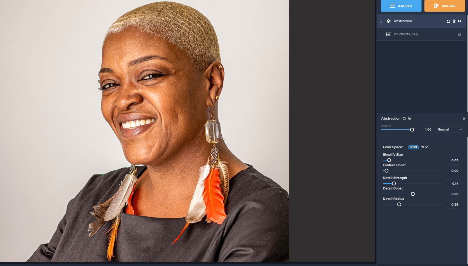

I have been using the products for about a year now. About two months ago worth of updates, I can no longer make it a part of my workflow where the technology was heavily influencing my style. all of my pictures look like the posted image. i would love to hear solutions. I get this result in the old studio, new studio, denoise, and this is defiantly putting me at a crossroads with the brand I invested in. this sucks

@lemycubill Ok I took your original photo and ran some experiments. First I could easily reproduce your rough skin results in Studio 2. As you zoom in it pretty much disappears so it has to do with the sub sampling Topaz uses to produce a small picture. You may open a issue and include the picture to see if they can fix this. Her skin is dark and has a lot of texture which you don’t get with white skin except with old folks.
In Studio 2 you can use the Abstraction filter where the Simplify slider can reduce the texture (see below). If you want really good results, try Luminar 4. Its great for portraits and I show a result below.

Abstraction Filter in S2:

Your Awesome! I like the abstraction solution! you deserve a money tree
If needed on some pictures, you can apply AI Clear after the Abstraction filter to further reduce noise. I tried it and there are no artifacts.
