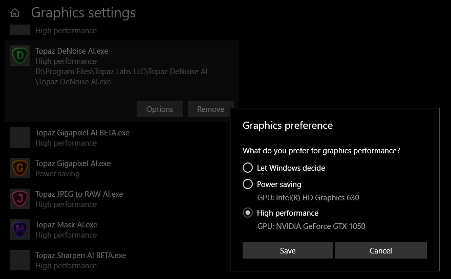

Are you sure that the GPU is allocated under the Windows, Settings, Graphics Settings like this, and you have calibrated each of the applications from their preferences as with the i7 it should choose the OpenVINO instead of the GPU?
For example, in my case I have an i7 with a GTX1050 & 4GB and it chooses this:
It will ONLY choose the GPU if it is faster.
Yes, I have the similar options to select the Nvidia 940MX as the preferred option. When I choose NO Topaz software will load. If I disable the card in Device Manager all the Topaz software works but very slowly.
