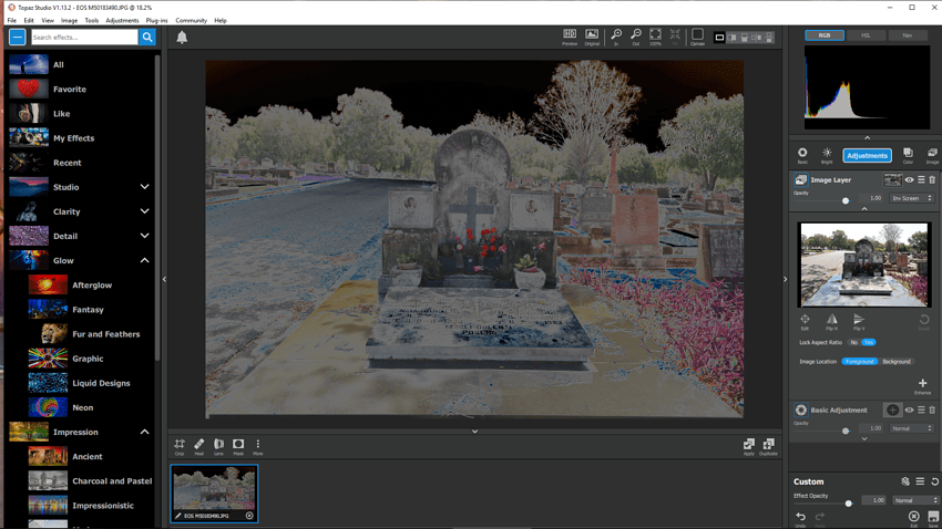

Sharon, I’ve decided to share my Topaz Studio Infrared simulation file by posting in Dropbox. You can do a lot of IR type looks using this in Topaz studio if you have the adjustments (not sure if the adjustment still works if you don’t own it). Here are some basic instructions though most of these are near correct already. Dropbox - File Deleted
  1. Turn off AI clear if it is on, until you are finished.
  2. Adjust the color overlay color to get the look you want.
  3. Adjust the B&W adjustment to darken blues and lighten greens and yellows.
  4. adjust other layers as needed.
The file contains an example picture.

One primary reason software isn’t a true solution, is that it can’t tell the difference between plants and non-plants. Software will, for example, apply the IR effect to a green car or building as well as green plants because it doesn’t have the complete picture when it comes to spectral components of green paint versus a living green plant. (giving myself the thumbs up for that pun :+1:)
IR photography can be used to study variations in vegetation because it not only sees living green and inanimate green differently, it also sees a difference between things like grass, trees, crops, soil, moisture content, etc. As an example, this enables farmers and the US Department of Agriculture to monitor crop health, moisture and compliance based on their respective spectra.
I think software can make nice IR-like images, but I would think it very difficult to make truly accurate conversions.
In addition to the effect of sensor filters, IR wavelengths are different enough from visible light to affect focus. One often gets soft images when using an on-the-lens IR filter; so you may need to make adjustments for that. Many lenses have IR adjustment marks on the focus ring. Even if you do a camera conversion, this is still an issue because the lenses and focus system are designed for visible light.

You can make a false IR composite just like those from the Ektachrome IR colour film. You make a normal colour image and you lose the blue layer in the old image – and then promote the red layer in the old image to become the green layer in the new image – and then promote the green layer in the old image to become the blue layer in the new image. As a separate shot you take an IR filtered image from which you lose the blue and green layers — the red layer becomes the red layer in the new image you are building — tried it – it does work but my results need some fine tuning!
There are usually different reasons for doing IR photography. Most typical photographers are doing it for artistic reasons but it is expensive and getting a camera conversion often means it will only do IR, though I have heard of full spectrum conversions. A simulation costs nothing if you have the software like Topaz but is very hard to look realistic (though not 100% accurate).
I spent probably 25 hours of experimenting to find a new sim that can work on most pictures for the artistic IR look. Topaz adjustments allow it to look good but of course simulation is not for scientific purposes. I think it would be hard to use AI for this purpose since it has to recognize living vs non living things and things that absorb/radiate heat (as you pointed out). Might be done but probably not be worth it for artistic effects.
I would suggest that anyone creating a tsp file for sharing, first reduce the picture size to about 1500 pixels on longest side. This will keep the upload and download size smaller.
