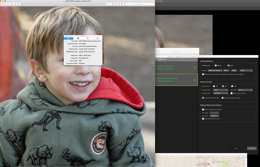

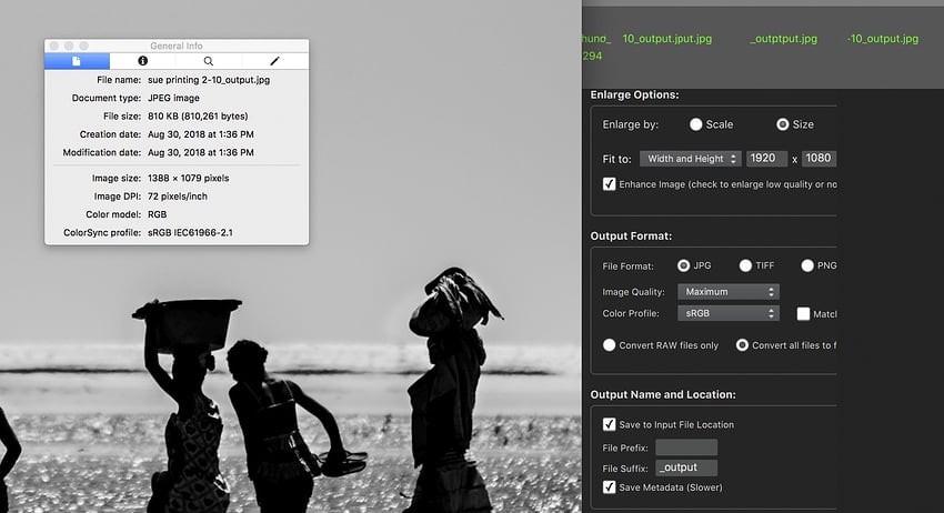

I indicate one size and the app outputs a different size acc. Preview’s
Inspector. See attached, also sent to Help multiple times.
3000 x 4200 becomes 2805 x 2875.
I was just told this was a known bug - is that possible??

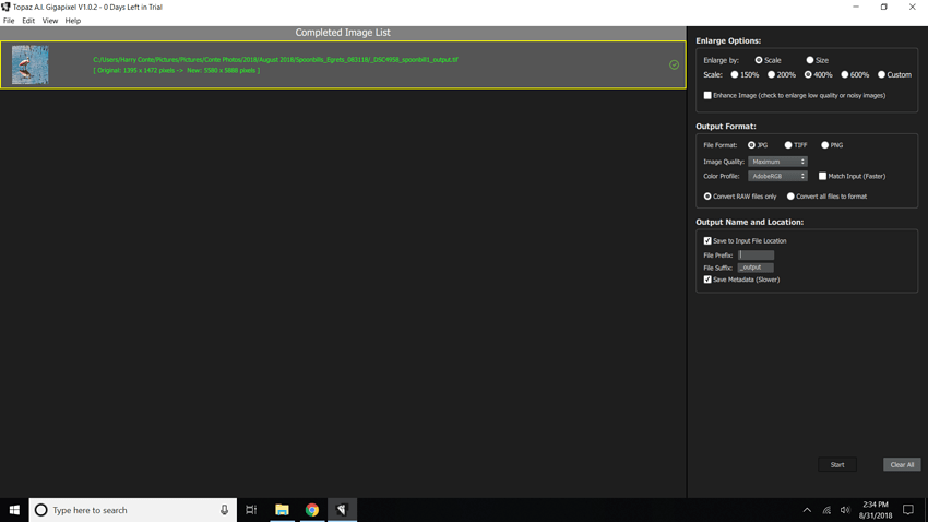

Okay, I’m sure it’s something I don’t understand or doing wrong. I just increased the size of a photo I cropped to 400% increase. It was a TIFF going in and I had set the program to size and produce a JPEG. Looking at the screenshot did I do something wrong? It produced a TIFF.
You’ve got it set to convert raw files only - so TIFFs, JPEGS etc. will stay in their original format.
Here’s the before and after shots. The original was shot in RAW + JPEG. I had to change the original to a JPEG to reduce it. The after was cropped from the original and then some dodging and burning was done. Then I used AI Gigapixel to increase the size. Unfortunately I couldn’t put the Gigapixel results here as I had to use Pixelresizer to post.
I knew it was me. Thanks for the help pmeach.
