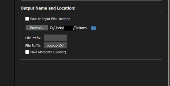

AI Gigapixel is a batch process so you will need to use the Output Name and Location: part of the panel on the right to specify the name and folder where you want the resulting processed image saved.
I think you’ll enjoy working with AI Gigapixel (AIG) and discovering what it can do for you! Both for individual photos and batches of photos…
After you launch AI Gigapixel, look on the right side of the interface. Down towards the bottom there’s a section called “Output”. I’ll attach a couple snips so you can see two different ways of approaching where to save… (1) You can either have your AIG image(s) stored back into the same image folder where your original images are located (see my snip with that box checked on), or (2) You can uncheck that box (yep, another snip attached!) to browse your computer and decide where you want the AIG output to go.
A handy tip I use to make it easier to spot the AIG output files is this: if you look down to the option in that Output box that says “File Suffix” … After the word “output” in the grey box to the right of those words I add a hyphen. Following that hyphen I enter the amount of upsizing I used in AIG. For instance, if I upsize 400%, I’ll doctor that entry to read …-output-400 . That way when I scan down my list of image filenames it’s easier to spot the ones I enlarged with AIG. And, if you want to try different scaling options for a single image then you know which is which. Neat, hunh?
