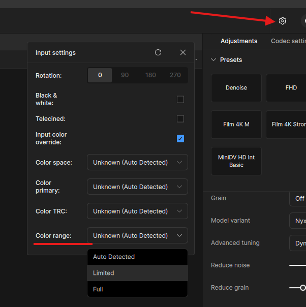

I did not know that menu even existed. Thanks for pointing it out to me.
However, I have to set the parameters one video at a time. This can be time consuming when you have 900 videos to process. I tried to set the parameters to multiple selected videos, but the settings button is disabled when you have more than one selected.
It would also be reassuring to SEE the change in the viewer when you make the change. The whole settings panel is unstable with random behaviour that doesn’t reassure me that I have the settings correct. Lot’s of going back and forth. Much like the Pixel Type setting that keeps going back to square no matter how many times I change it to Original.

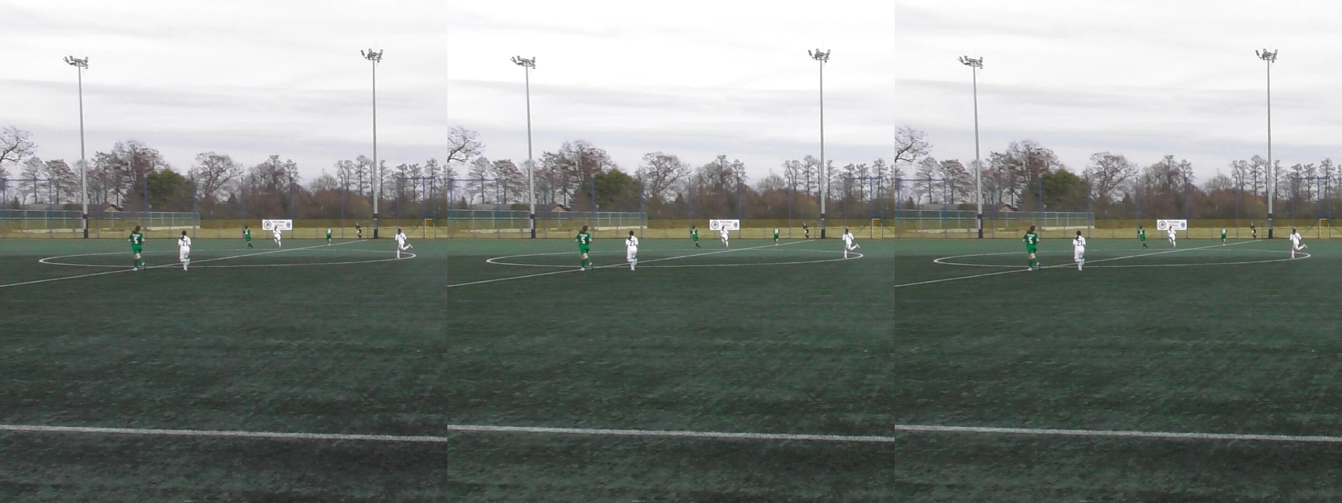

Here’s an example:
left - RGB correction ; middle - original (Sony camera) ; right - Y correction (linear)
Thanks for the detailed explanation!
Result is inded superclear. I do prefer sat ^^

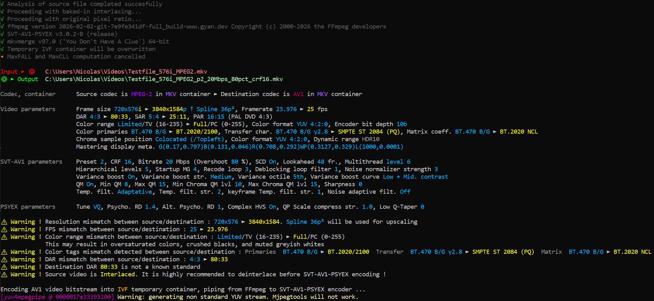

Something like this, fully written in batsh script (insane challenge xD )
I see a common problem. The source is probably BT709, not BT601/470BG. FFmpeg assigns BT601 when matrix information is missing. They should have done this a long time ago, as many programs do – in the absence of matrix information, if width >= 1024 or height >= 576, the matrix is BT709.
Thanks for pointing this

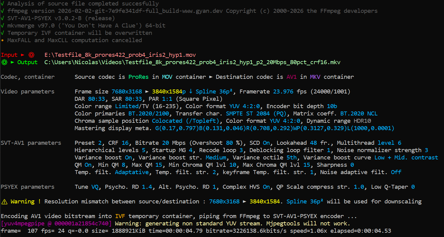

In fact whatever a mismatch appears between source destination, it will be yellow outlined
In this case, I force a mismatch to test my script
It’s allmost ready to be released but I want an accurante MaxFALL / MaxCLL computation
I noticed the non linearity of PQ curve and some problem with a LUT table
Running some tests with calibrated MaxFALL and CLL to compare mines to real ones

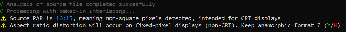

I added some various codec and container compatibility, but now the biggest pain is batch “language”, all special characters !()-%! are a TRUE pain to escape properly
