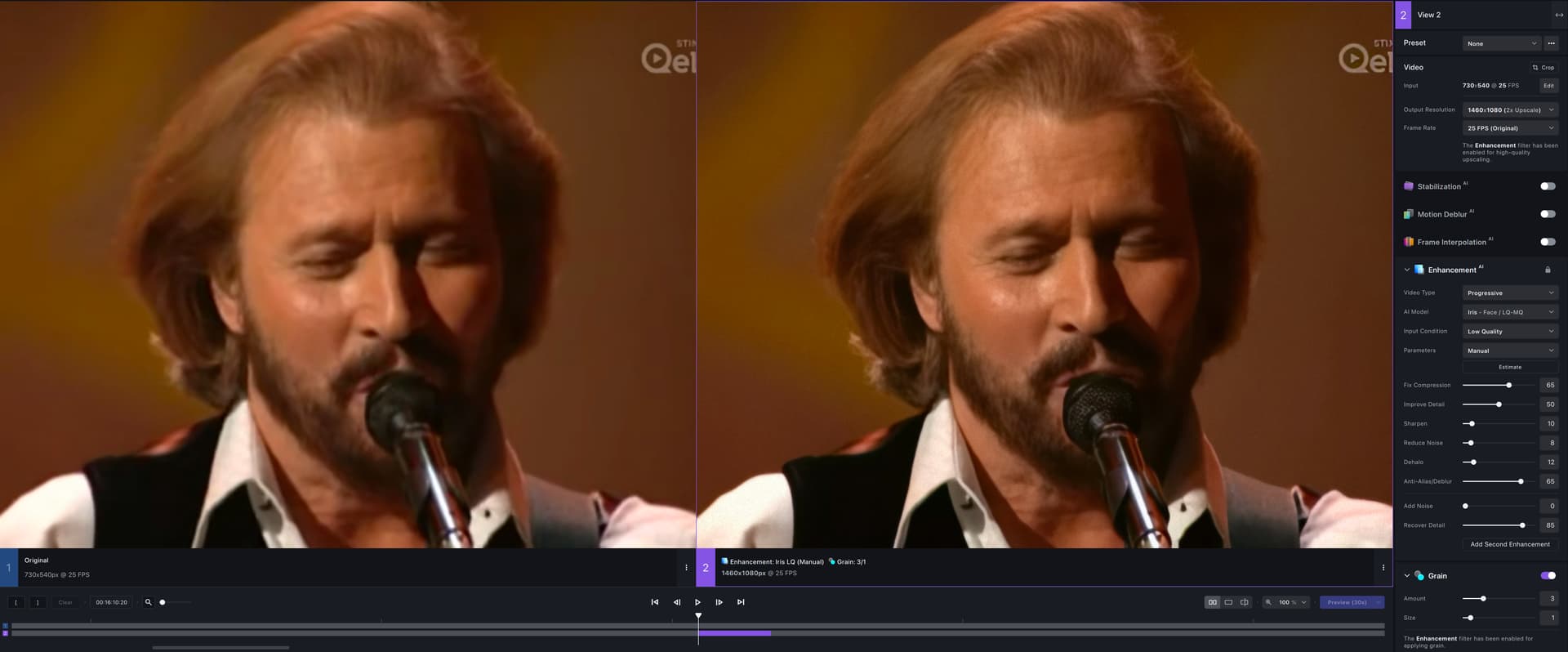

Bildschirmfoto 2023-12-01 um 17.34.16
I would only turn on stabilization and Deblur if really necessary. Upscaling 2x automatically enables “Enhancement” where you can then chose the used model:
The preset uses Proteus which isn’t bad at all - but I mostly prefer Iris.
These are my preferred settings for LQ SD material:
