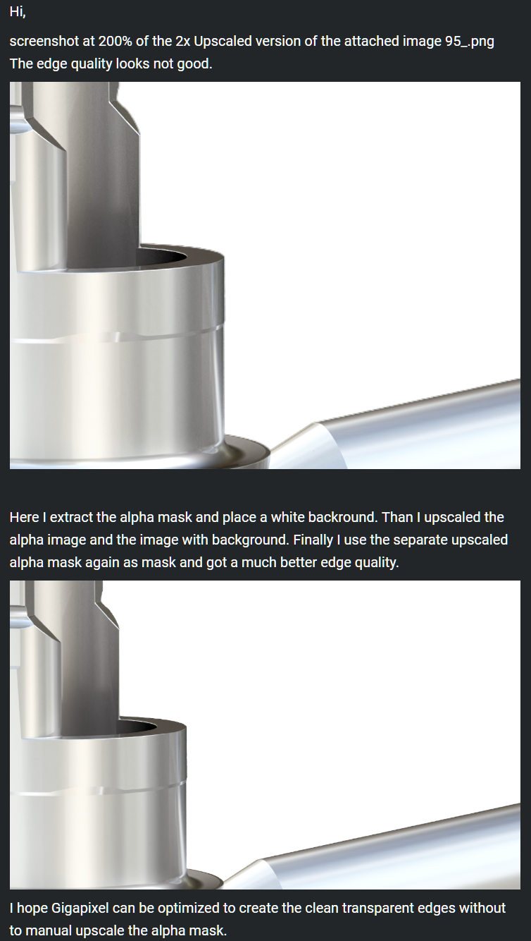

I run in the same issue - I tried to upscale renderings. It looks like the problem is that the alpha channel isn’t AI upscaled, only poor upscaled.
Here an example where I used a black image where the image information is in the alpha only.
@timoteo I found a workaround - I extract the alpha channel per free image browser XnView and saved it to a separate file. From the original image I removed the alpha. Now I AI upscaled both images and combine it later again. So I got an upscaled version with sharp edges.
Side note: to get no artefacts at the edges it’s good to choose an useful color as background during the step of removing the alpha. Best would be to use an grown version of the original. One way I found is placing some copies of a blurred version in the background before removing the alpha.
I hope AI Gigapixel will automatic handle this issue and provide the full quality. My workaround shows it’s quite easy possible.
Here an example of my workaround that I posted at the support side.
