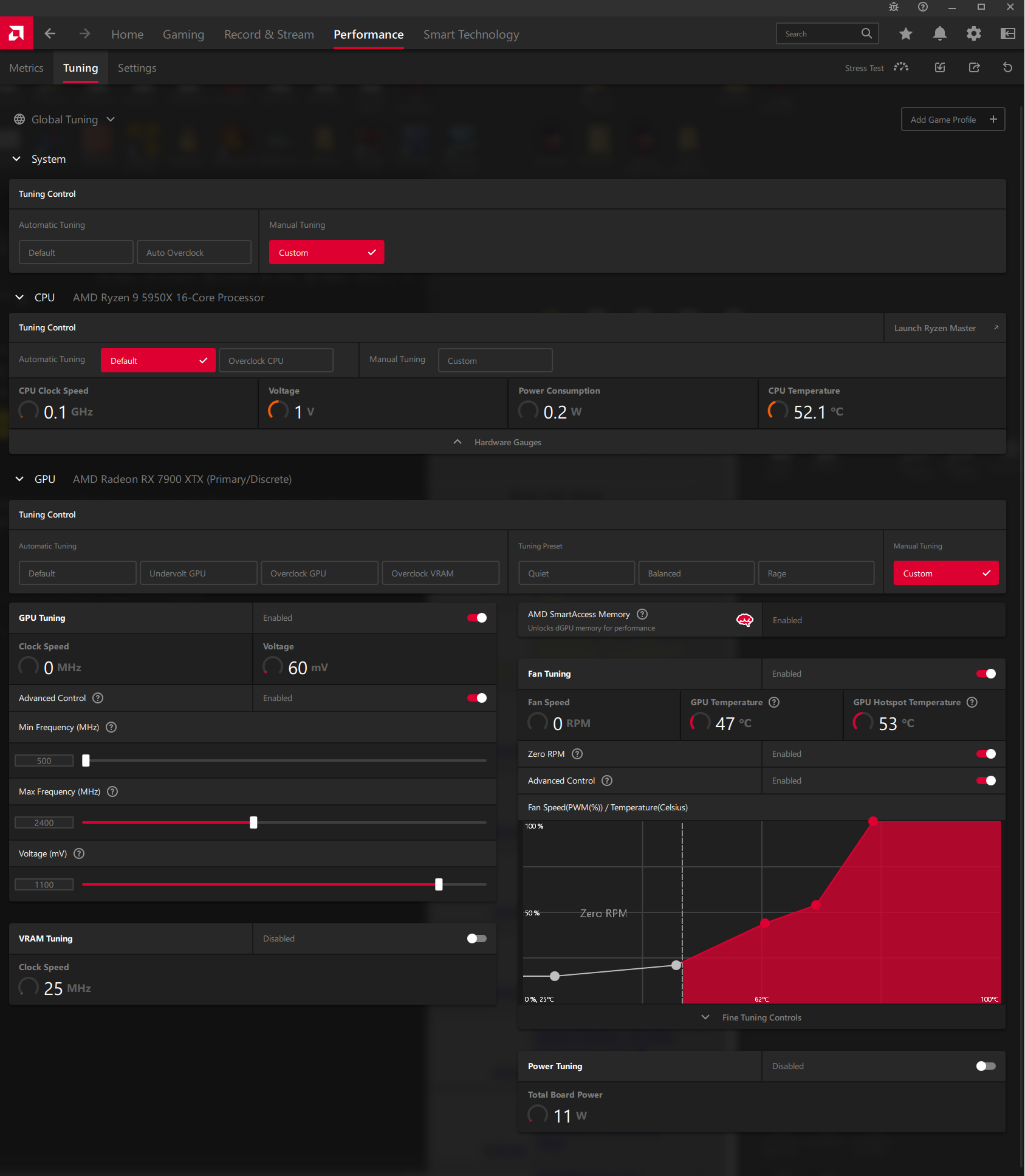

My topaz Adrenalin setting (25.3.1)…
Performance/tuning/
Tuning Control
Manual tuning-Custom
Turn on GPU tuning Control-Custom
Gpu Tuning-Enabled
Advanced Control-Enabled
The main thing for me is the Voltage (mV) slider, It is an “offset” on the mVs
Some of the tutorials show the slider listed as an “offset” mine does NOT.
I set the mV slider to 1100 and got the…
Power drop 300-400 something watts to 200 something watts
Hot spot drop degrees C from 80-90s to 65 C
(good enough for me!)
