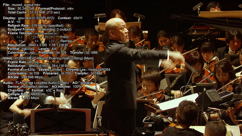

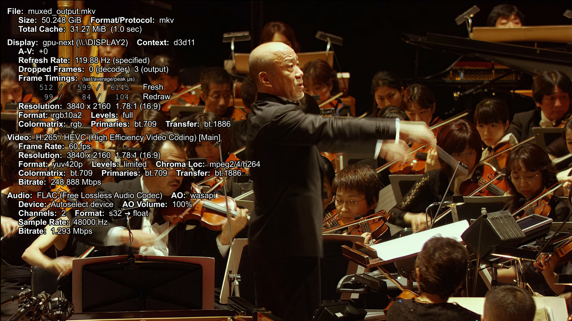

Getting a closer look at the Precise 2.5 render - the best example of it is from the really wide, 100ft or more feet away from the orchestra/chorus members. Under Rhea’s interpolation and Aion’s enhancement, they’re blocky and much noisier (random video noise). Precise makes a better effort (it’d had better for as long as it takes).
I don’t have a screen capture process above 1080P yet, so it’s difficult to do an accurate screen compare. The player (open source) MPV allows me to layer multiple instances over one another, and I can just highlight the taskbar icon and switch back and forth rapidly between the two 4K frames, and Precise’s precision is obvious.

Hi Folks- The Precise 2.5 render looks very good on my editing monitor, and outstanding on the 83" S95 in the living room - so this recovery attempt is a must-do. I was able to put Windows Update on hold until July 10th.
