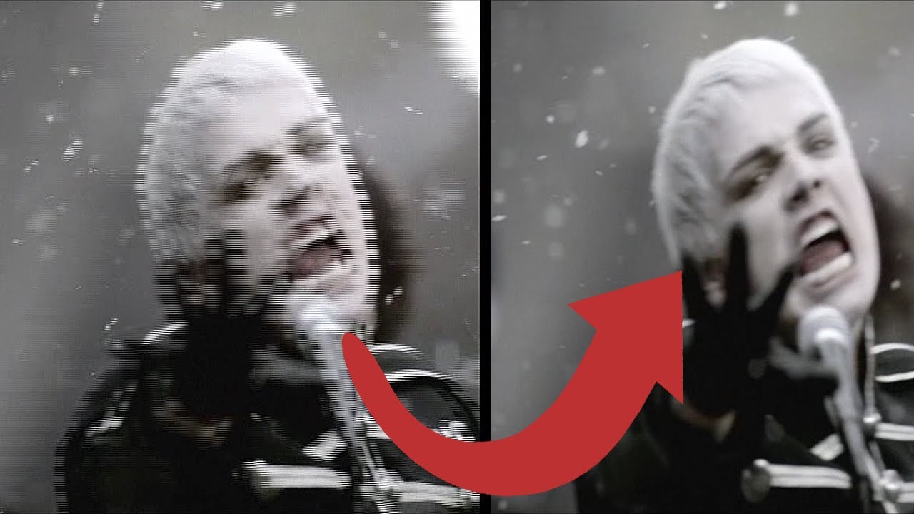

I have a movie produced (by us) some 20 years ago. It was shot on 35mm film at 24fps. All of the 35mm reels were telecined to Digital Beta with 3:2 pulldown. The film was then edited in a video based NLE and mastered to video at 29.97fps.
I’m trying to bump-up the movie from SD to 4K. My first pass is using Dione V2 (V3 makes a mess of it, none of the other models can fix the interlacing) at 100% Denoise. Jumping straight to 4K from 3:2 interlaced SD results in a bigger mess than its worth. Two passes … looks amazing. Except …
Problem
Topaz introduces a visible and painfully noticeable alternating White and Black glow around objects in motion on the two interlaced frames. When played at normal speed, it looks like a weird pulsing flicker that didn’t exist previously.
