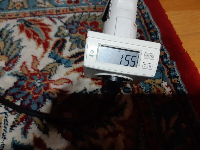

My average power draw while rendering dropped by 200w and hasn’t crashed in the last 40 minutes or so.
Interesting observations:
Running on 16 threads and scaling back the gpu hasn’t affected the speed of the rendering. If anything, it maybe slightly faster.
Although the average draw is 200w less; I’m seeing spikes up to 576w. I am thinking that my psu was shutting down prior to my change and was spiking high enough to shutdown psu.
