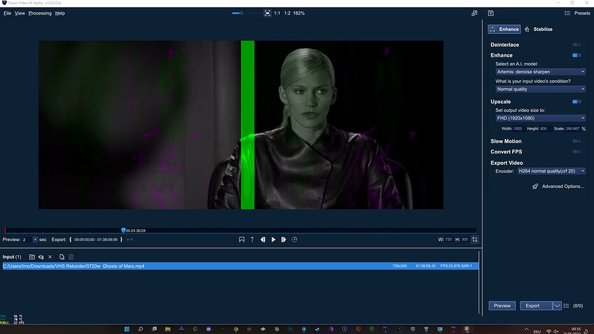

This version is still not getting the opened video right showing it black and white with magenta and green parts.
