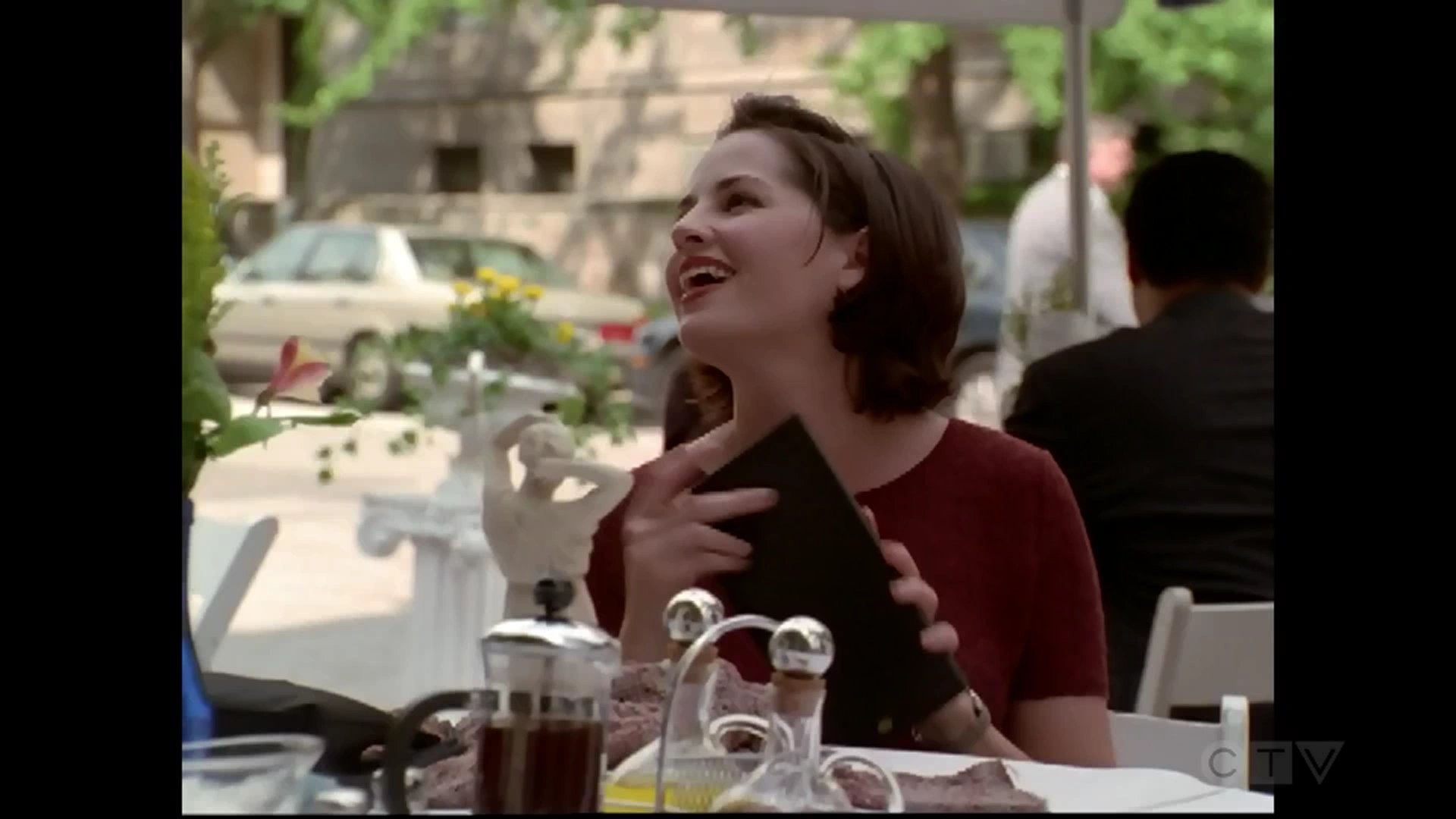

This video was poorly deinterlaced by a tv channel and upscaled to 540p for web streaming with a lot of compression. I think the source was 480i.

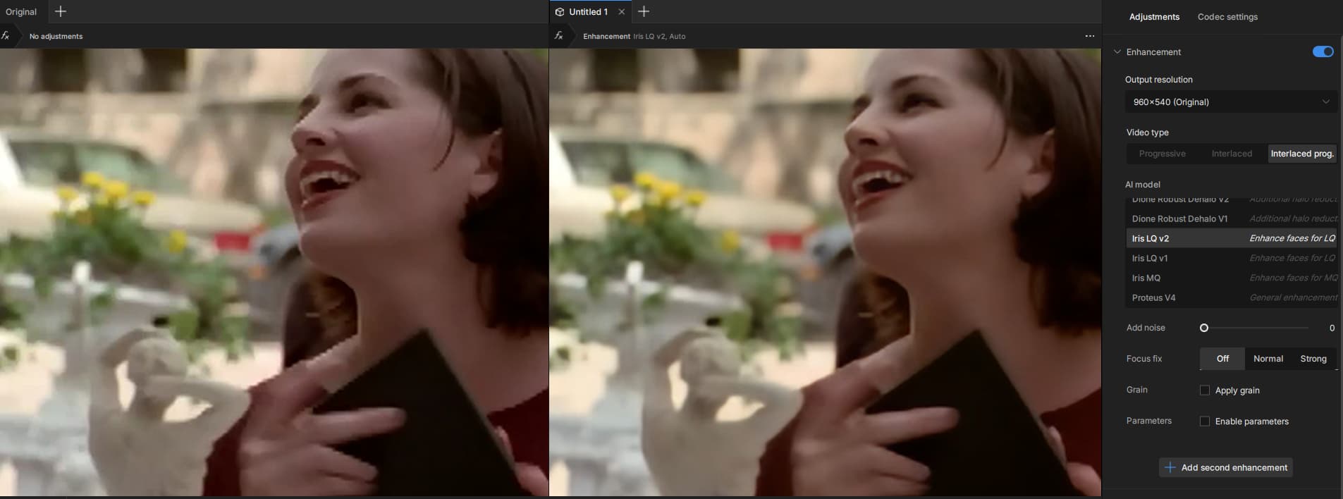

I did a quick test with the video type set to Interlaced Progressive with Iris LQ v2 and got this:
Yes Iris does this when jagged is not to heavy, here it’s medium on the limit but works, also Iris MQ does this and looks more film like.

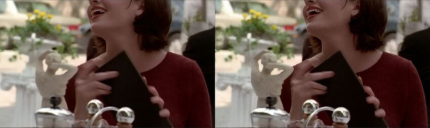

without upscale, zoomed in: IrisMQ default, recovery Details=0, add grain size=1 , ammount=2

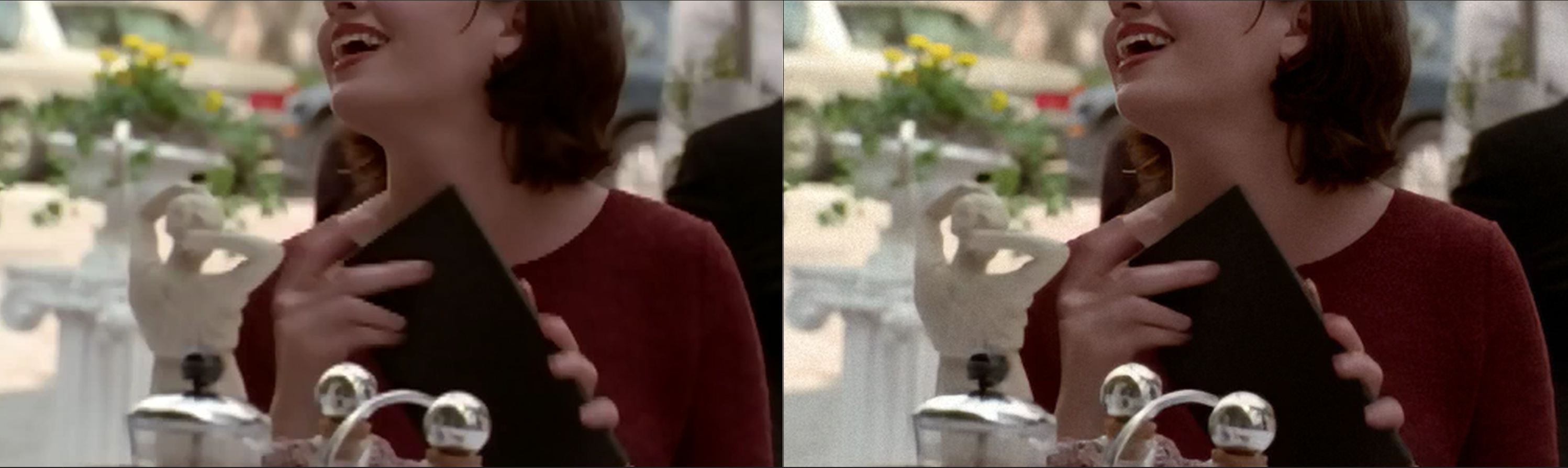

same but Iris MQ 2x upscaled to 1080p
above link, click on “+” for better/fullsize view, and mouse wheel to zoom

yes my first screenshot is without upscale most of the jagged is gone too, so this is quit interesting Iris helps, both LQ and MQ
