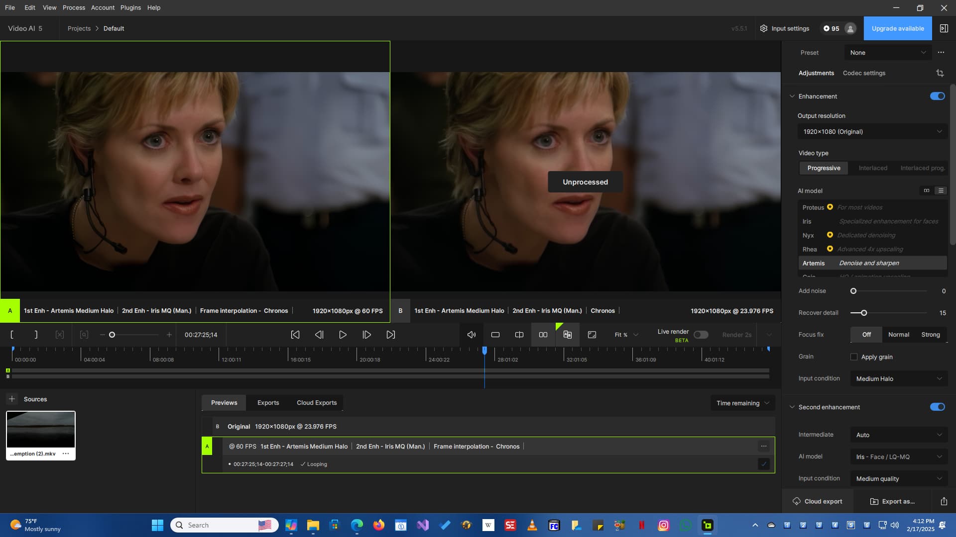

In upscaling a Stargate episode, suddenly Video AI has stopped copying the soundtrack. I went back to another episode I’d already done, and the new rendering also has no sound, though it did the first time.

Further note: I tried with a completely different file, and it worked. So the problem must be the way that episode’s audio codec is embedded, or something like that.
Paul
Aha! The problem was the Artemis enhancement model. When I tried different models, the audio track came through.
Paul
Hi Paul, sorry I missed this! Just getting around to it, could you let me know the file name that was uploaded to my dropbox? I’d like to run some tests and see why Artemis is the only model causing the lack of audio with the export. Thanks!
