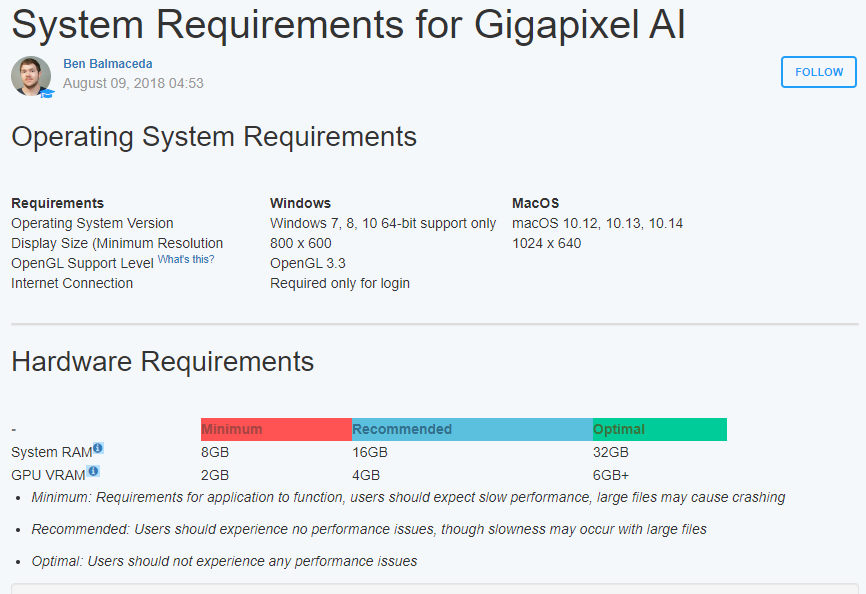

If you wish Topaz to create a tool like that then would need to put a Support request in but the requirements are quite specific on the website. For example, these are for GigaPixel AI and it clearly states the Optimal requirements:

Neither do I want to offend anybody, but in all honesty I think these requirements are only correct (while neglecting which CPU) for TL used as a standalone application not when you use TL as a plugin in PS or LR
On top of this looking at the requirements I think they are to vague.
What I and I’m sure a lot of folks would like to see is 3 or even 4 listings for required hardware including:
CPU, amount DRAM, GPU, amount and kind of VRAM, Screen Rez and a timing for a 50MB file.
When done for ‘minimal’, ‘recommended’, ‘optimal’ and let’s say ‘superb’ this could be used as an indication for people (like I was) looking for info regarding the required hardware and what to expect from their current setup.
