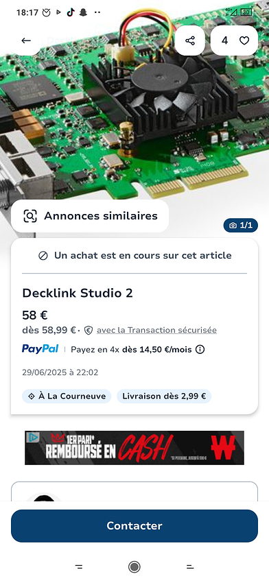

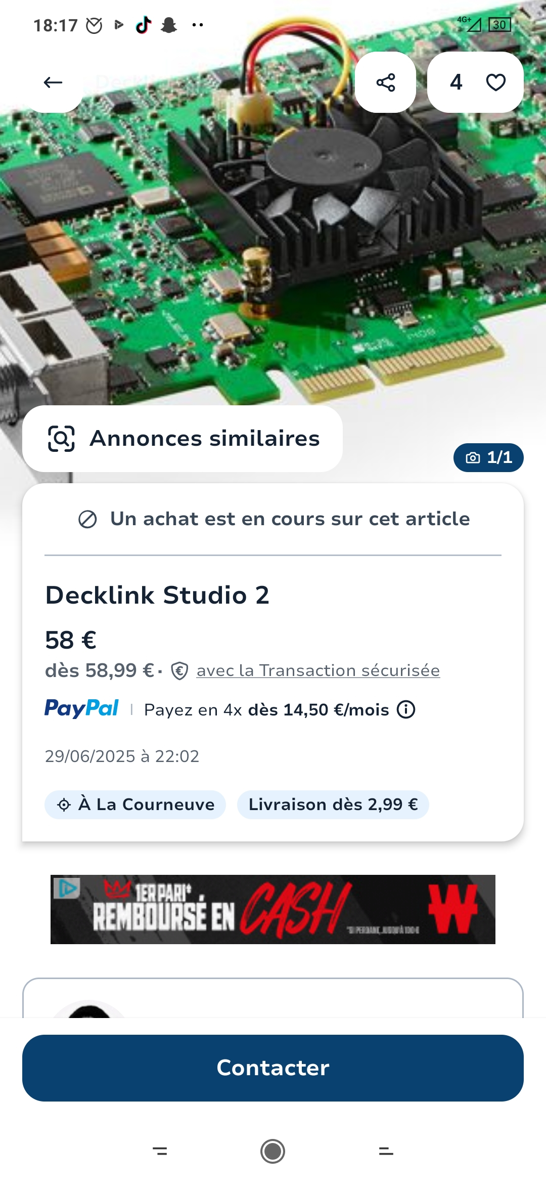

Indeed, I thought DV was the best way. I’m in France, so it’s PAL 25/50, DV 420 25 Mbps. I found a way to get even better quality: digitizing in RF with the necessary equipment. Otherwise, I was advised to use the Blackmagic Intensity Shuffle for digitizing in S-Video.
But I found this one, I ordered it straight away!
