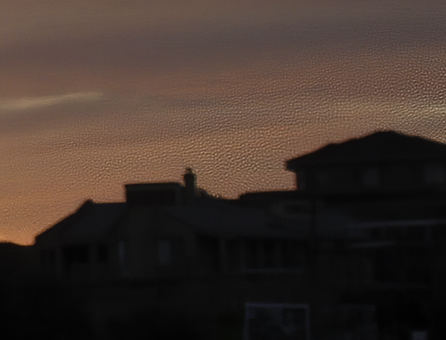

When I take some of my jpegs and use JPEG_RAW on them, I get weird artefacts on them: weird bubbles and streaking/lining. They are microscopic (viewed at 100% +zoom) but carry on through the other Topaz processes and usually get worse and worse.
If I AI sharpen the image first, this seems to help the problem. So to me, if the image is not sharp jpg-raw is doing more then jpg-raw sharpening and getting thees weird results.

![IMG_0630-jpg-raw%20weird|850x647]![IMG_0630-jpg-raw%20weird|850x647]
The original image is a jpeg, 5.6 Mb, 5200x3400.
Others have had lines rather than bubbles, but I did not keep copies. The effect seems worst on smooth areas; sky etc, but that is just from limited experience.
I tried to attach a detailed crop after jpeg-raw. I keep being told I can’t put an image in a post

That isn’t noise, it is artifacts on your result. I wanted to see the input to work out why.

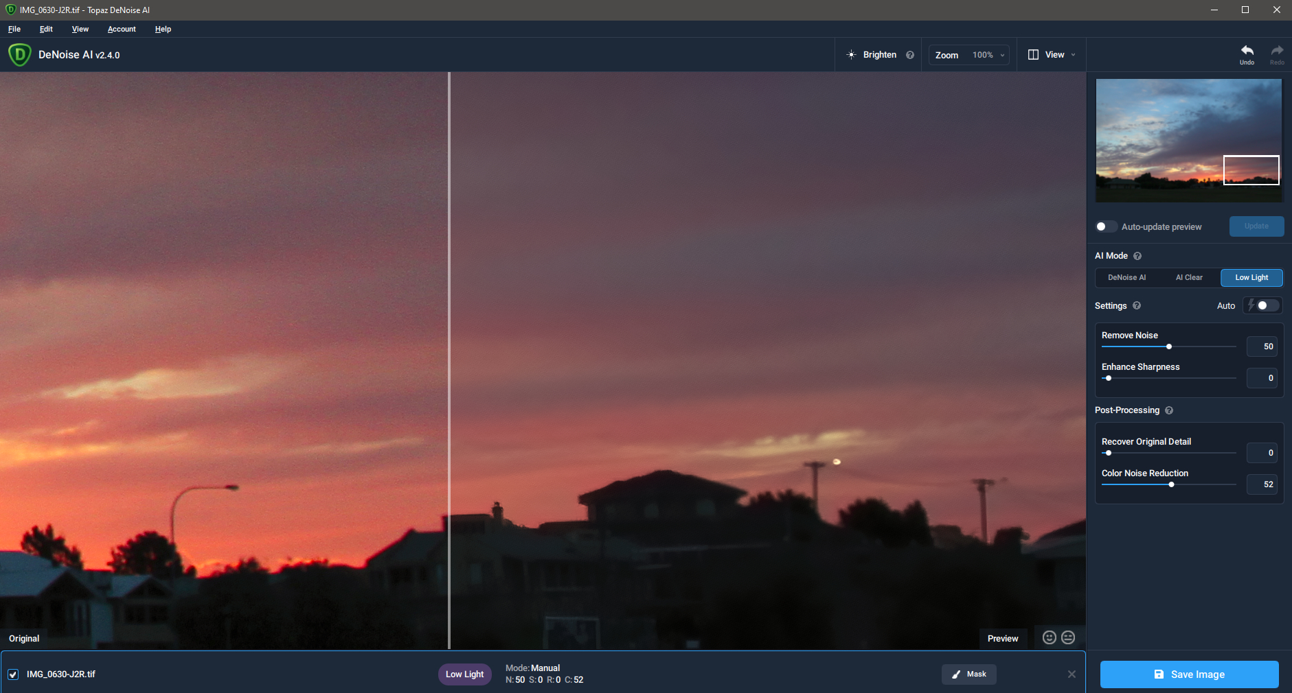

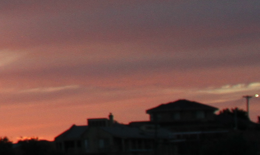

The original has artifacts and quite a lot of Noise:
After JPEG to RAW, TIF output I get the following, a little better:
Then using DeNoise AI, Low Light model I get the following:
I haven’t tried it the other way around starting with applying Noise reduction to the JPEG but you could try the same settings of AI Clear Auto … unfortunately though, because of JPEG compression, it might not work as well starting with the JPEG then using JPEG to RAW.
Note that the Canon 7D didn’t handle low light noise very well, but it can be corrected as I see above.
OK. I think I have fallen into the trap of getting a bit lazy using Topaz’s offerings and I need to pay more attention to the options. I can certainly use other options, as you have, to get better results. Basically if it does not work, try another option, before blaming the result.
I have seen your moon shots and it’s not the moon that is green cheese. Amazing shots.
But I have used Topaz to get a result form a pretty old, jpeg, taken in a city on a warm night, 200mm lens, shot of the moon, that has dragged out details from jpeg mash, that nothing else could do.
So if it’s not good enough, try again before I grumble. :slight_smile:
I cannot believe your patience. Thank you.
Nick
Your welcome, as you can see from my screen shots … Always try Low Light with the Noise slider more than the auto setting and Sharpening set to 0 on images shot in low light.
