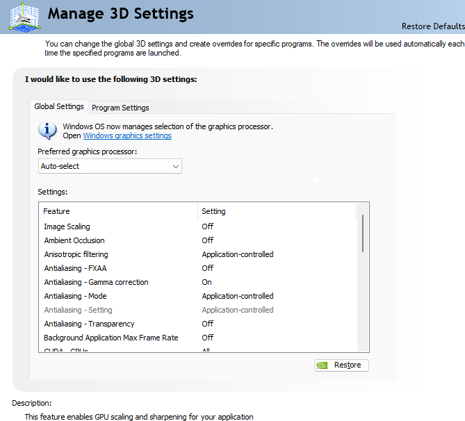

Thank you for the quick response. I have re-installed again and checked the settings with the Nvidia app, mine look like the snapshot below which seems to match your suggestion.
I have re-launched Topaz and now I can see the strip at the bottom and preview.
Not sure if the install had not worked the first time or if I needed a couple of restarts to bed in. It works anyway.
