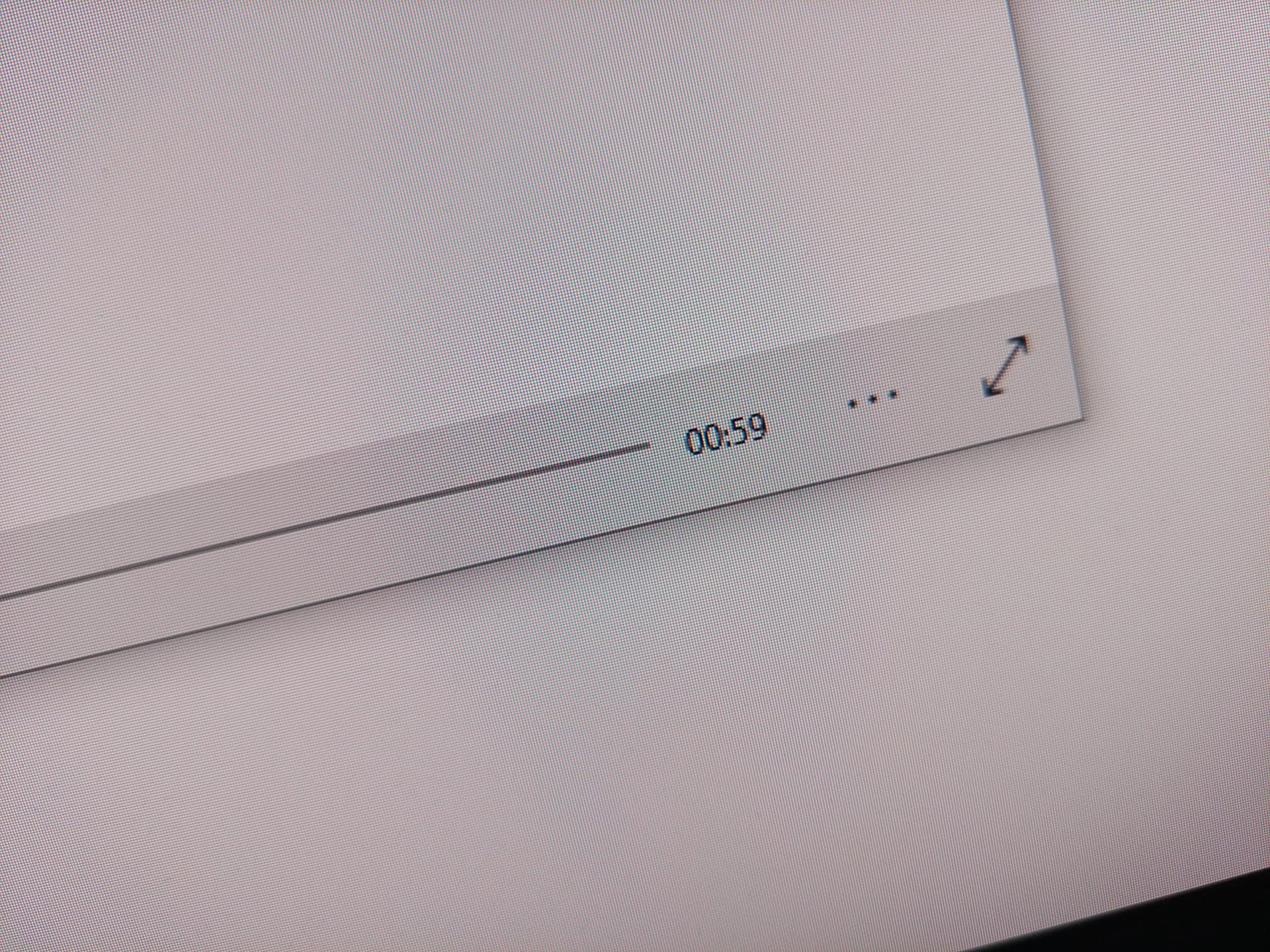

Stable played with Windows Photo

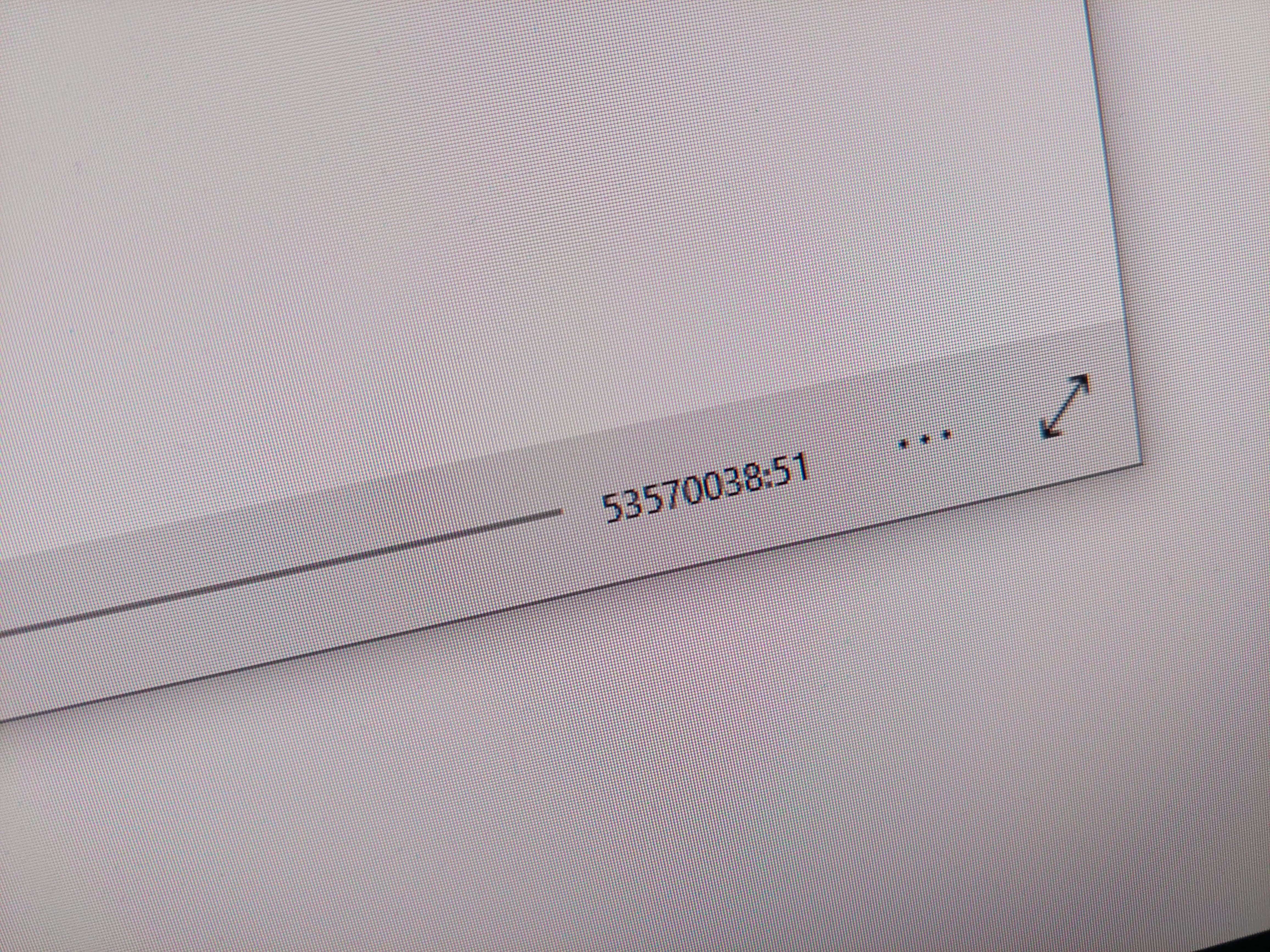

Alpha played with Windows Photo
look at the timeline, its broken.
I’m working on the mac and it seems fine in my testing. Let me try on windows and use the script we send out.
I notice that you are using a AMD GPU. We will have to test more on AMD AMF encoders, especially the codec options being used. Should be fixed in the next release.
