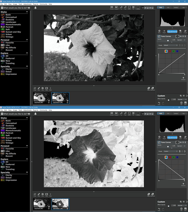

I don’t think it is possible as ReStyle is a HSL app … and the invert command in PS etc is just curve.

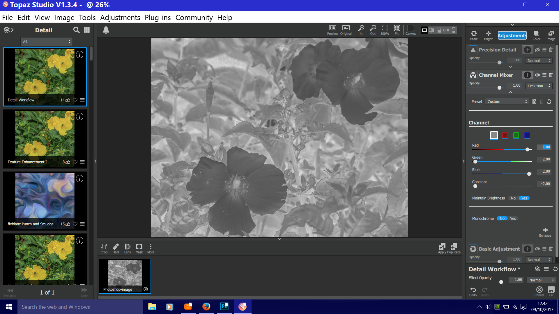

Actually succeeded to do this using the colour mixer in Detail - close the eye on Precision detail and Basic adjustments and then chnage the choice on Colour Mixer to Monochrome. then playing with the sliders you can get variations on B&W or W&B.

The blending mode was exclusion

I gave it a try and came up with the same suggestion as @AiDon. Then I use the basic adjustments to fine tune it. You can also use the Sat/Temp & Tint sliders too get different color results. And of course maybe adding some other adjustments will make it even better.
Here are my screen grabs with settings using your image:

Then opened in Studio (within PS) and go to Detail.
In Basic Adjustments Desaturate to give you a B&W image.
In Colour Mixer using these settings the B&W is inverted
Adjusting the settings will give you more varations but the blending mode does have to be exclusion. As you are in the Detail section more precision can be sdded with either Precision Detail and basic Adjustments.
