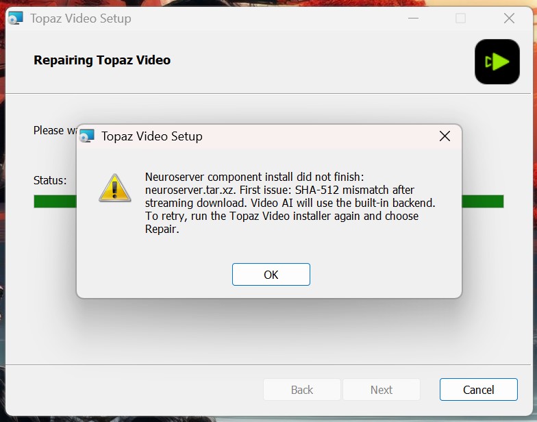

Topaz won't install neuroserver
It won’t download the second neuroserver file. 2 of 2. The first one, 1 of 2, downloads and installs fine.
I received the same error message when I downloaded the update.
Someone from Topaz please reply about this issue.
The 1.5.0 update literally borks neuroserver and therefore all Starlight models are useless.
HELP?!
We are aware of this issue and the devs are looking into it.
Some users have seen a resolution by following these steps:
Uninstall current app and remove all files and folders for Topaz Video
Download a clean installer for Topaz Video | 1.5.0 | Win
Run the installer, if it hits a snag, close it all down.
Remove these files if they are found on the system and then relaunch the installer with Admin privileges and choose Repair.
C:\Program Files\Topaz Labs LLC\Topaz Video\neuroserver-install-warning.txt
C:\Program Files\Topaz Labs LLC\Topaz Video\neuroserver-install-status.json
Please update here if you are still getting this error after these steps.
Update from the devs, for anyone seeing this issue with the SHA-512 issue.
Please go to the file path and delete the text document if you see it there, and then launch the app and try to run one of the Starlight models.
This should resolve the issue and allow the app to launch and Neuroserver to be used with the models.

[2026-05-14 21:20:47.362] [VEAI-Neuroserver] [NeuroserverGpuGate] Checking GPU for Neuroserver compatibility (NVIDIA min VRAM 7.00 GB, AMD min VRAM 11.00 GB)
[2026-05-14 21:20:47.362] [VEAI-Neuroserver] [NeuroserverGpuGate] - AMD Radeon RX 6700 (vendorId=0x1002, isNvidia=0, isAmd=1, dedicated VRAM 9.9563 GB)
[2026-05-14 21:20:47.362] [VEAI-Neuroserver] [NeuroserverGpuGate] Skipping AMD GPU below VRAM threshold: AMD Radeon RX 6700 (dedicated VRAM 9.9563 GB < 11.00 GB)
[2026-05-14 21:20:47.362] [VEAI-Neuroserver] [NeuroserverGpuGate] GPU gate failed: no NVIDIA GPU with >= 7.00 GB VRAM and no AMD GPU with >= 11.00 GB VRAM
[2026-05-14 21:20:47.362] [VEAI-Neuroserver] DetectSupportedGpuForNeuroserver: NEUROSERVER_GPU_OK=0 (NVIDIA min VRAM 7.0 GB, AMD min VRAM 11.0 GB)
[2026-05-14 21:20:47.378] [VEAI-Neuroserver] DetectExistingNeuroserver: INSTALLDIR not set yet; treating as fresh install
[2026-05-14 21:20:47.378] [VEAI-Neuroserver] DetectExistingNeuroserver: NEUROSERVER_ALREADY_INSTALLED=0
[2026-05-14 21:21:23.922] [VEAI-Neuroserver] Neuroserver version file not readable at C:\Program Files\Topaz Labs LLC\Topaz Video\neuroserver\version.json
[2026-05-14 21:21:23.922] [VEAI-Neuroserver] DetectExistingNeuroserver: no usable version.json at C:\Program Files\Topaz Labs LLC\Topaz Video\neuroserver\version.json
[2026-05-14 21:21:23.922] [VEAI-Neuroserver] DetectExistingNeuroserver: NEUROSERVER_ALREADY_INSTALLED=0
Is my problem 10GB AMD GC

Based on that sample of the log, yes the issue is the system does not meet the requirements but I would need to see the full log to get a better idea of everything. You can email the logs to me at help@topazlabs.com if you wish.
