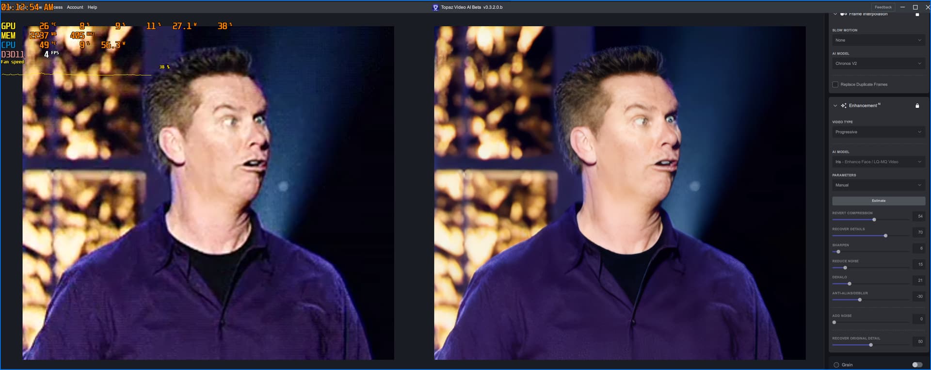

A tip for getting the most out of iris, I use these settings to combat the iris Vaseline coating effect:
  • 25-50% Revert Compression
  • 50-75% recover details
  • Sharpen can use the manual estimation setting.
  • Reduce Noise: depending on the Vaseline level, you can actually turn it right off!
  • Dehalo, same as reduce noise… yet helps with over-sharpening normally.
  • To combat the Vaseline, turn up the deblur!
  • Recover Original Detail, 50-75% works real well depending on how much was lost and replaced by the Vaseline effect!
  • Last but not least, you can tidy up the overall effect by using noise/grain!
This vid was 300×270, upscaled to 1920×1728 I also HIGHLY suggest re-encoding any (1080p, ⇐ my mistake) 720p or above video down to at least 640p or lower with lossless containers to get the BEST out of iris, ⇐(That is IF you’re only upscaling up to 1440p, for some 4k is too demanding) as iris really shines with 3-4x upscale jobs, most resolutions lower than 2x is no different from Proteus 3!
