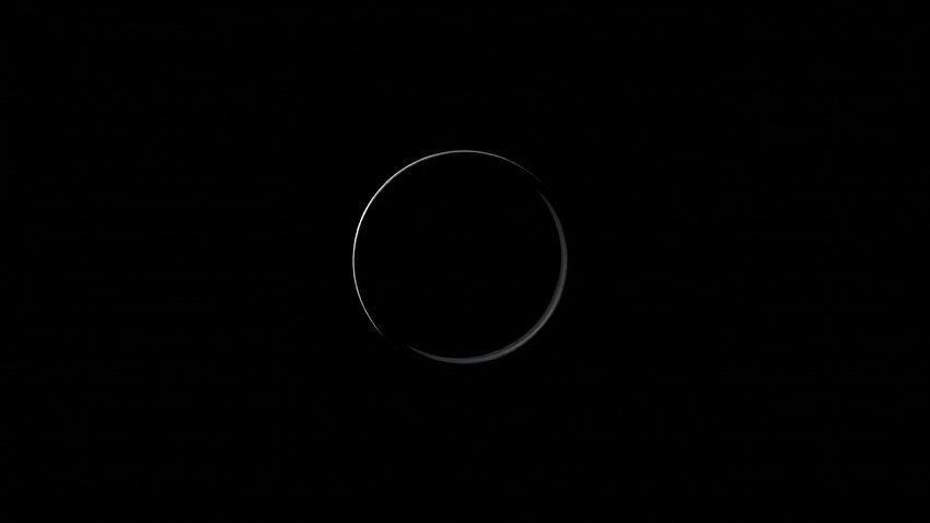

But anyway, I did a quick test by taking a 360p version of one of those OLED test videos and trying to upscale it to 1080p with both SL Mini and this new “SL Sharp”.

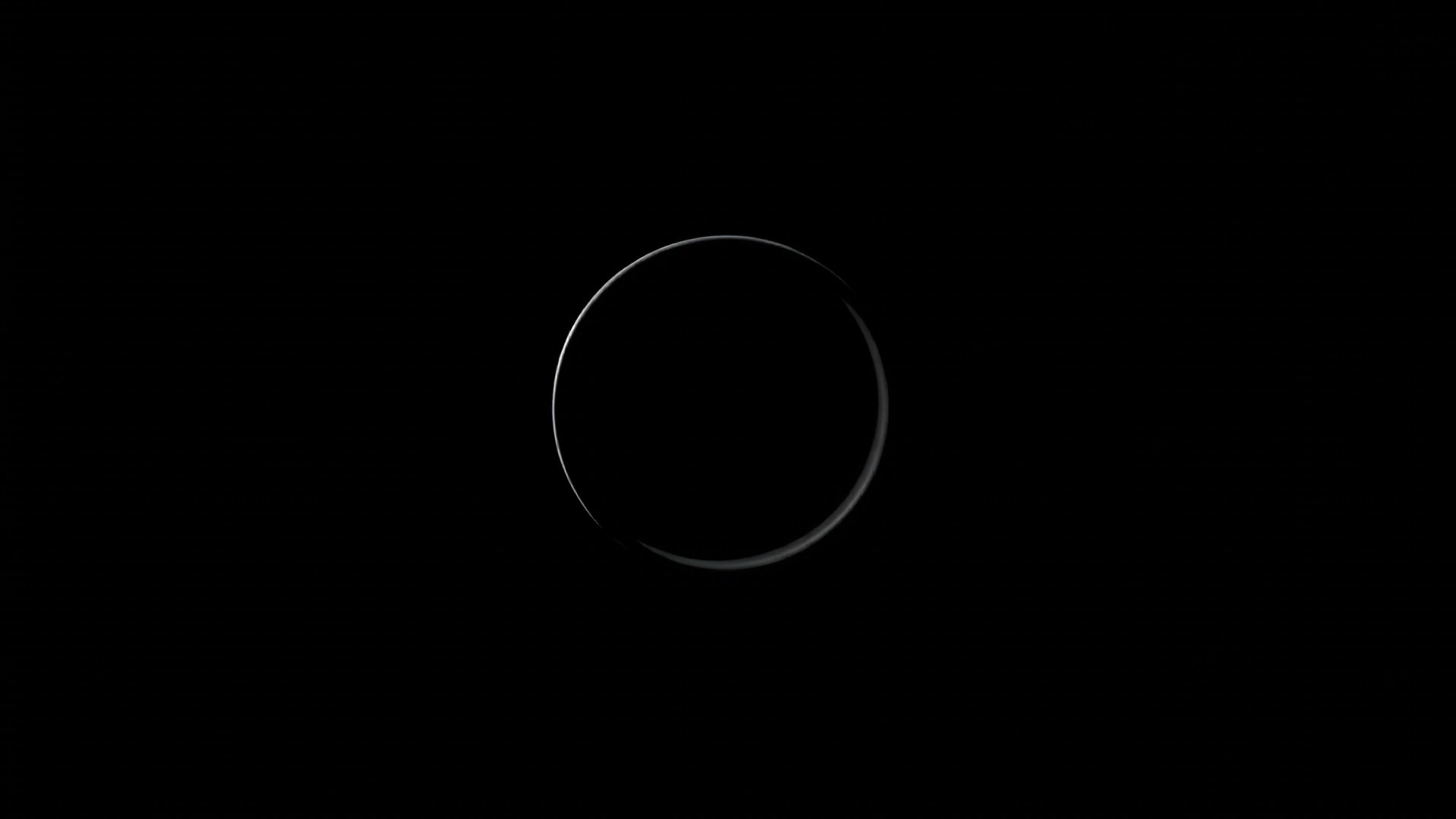

First, there is a problem with SL Sharp and even remotely big areas of darkness. Seems to create a gray checkerboard pattern:

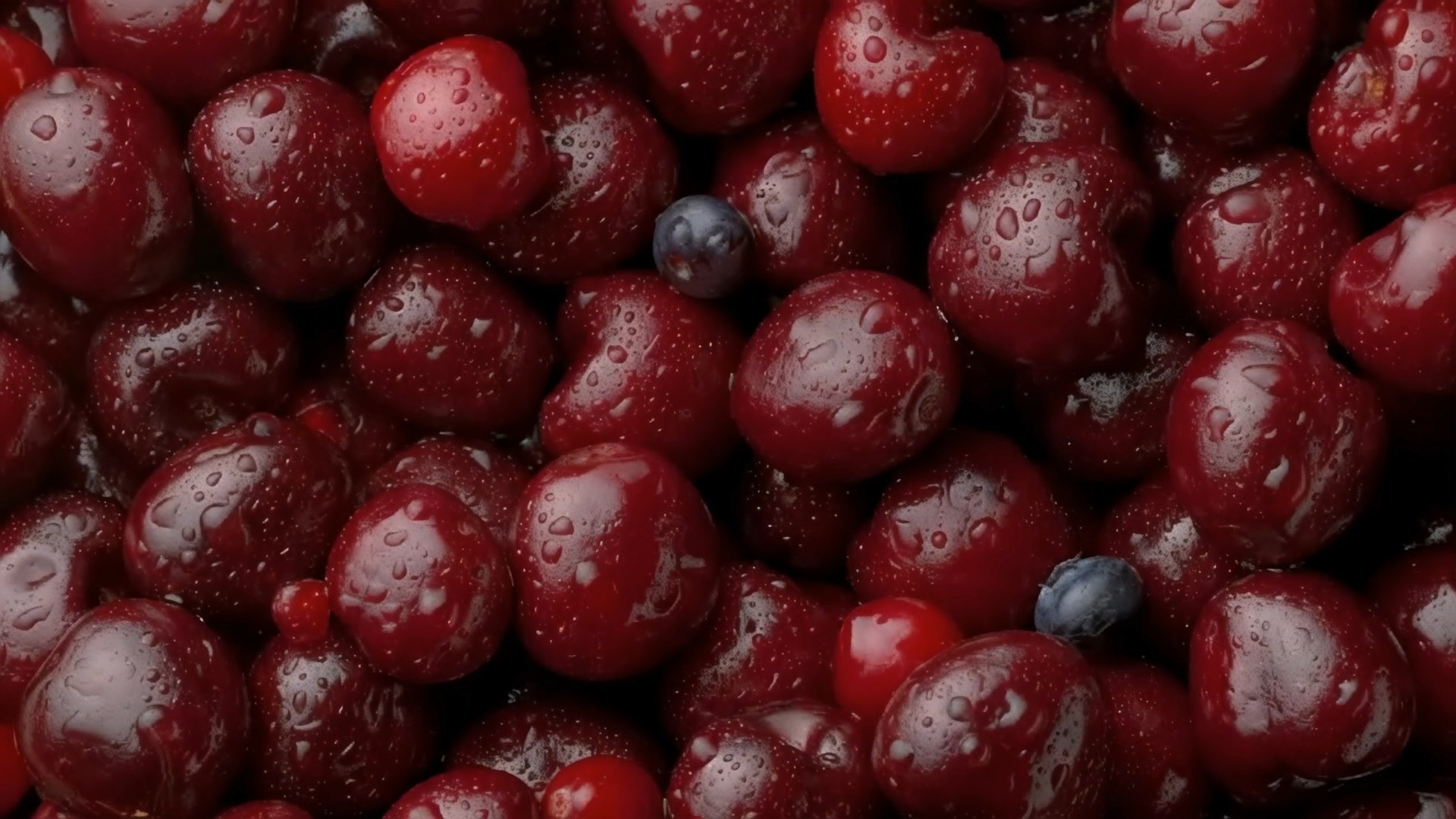

SL Sharp does retain specularity / surface sheen much better compared to SL Mini.
Here’s SL Sharp:
And SL Mini:
SL Sharp seems to swing for the fences a bit more in trying to create plausible material texture and light response, compared to SL Mini. For real-world objects, it seems pretty good, although the colors / sharpening can make things a bit more garish-looking as well.

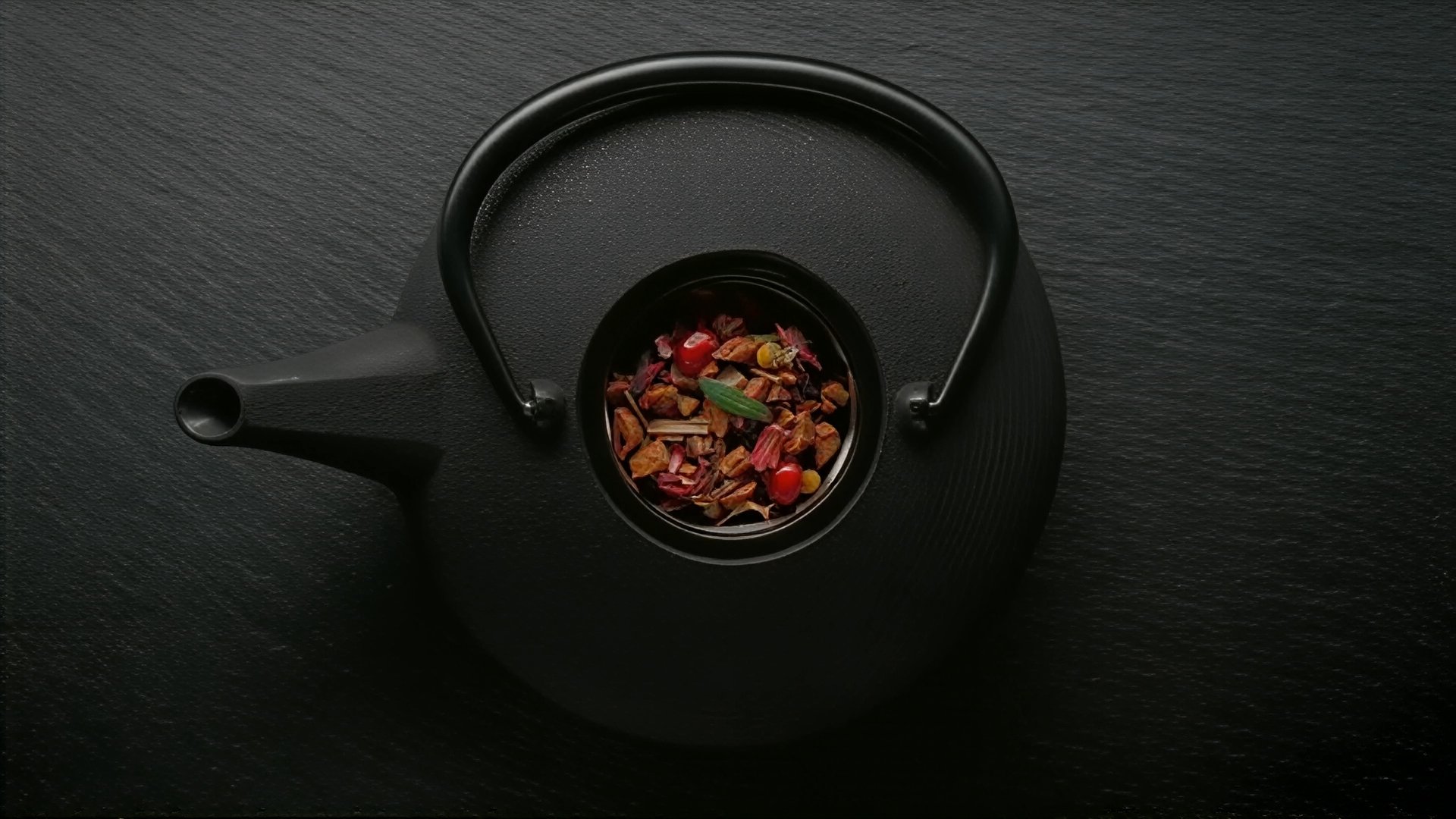

Here’s the original 360p frame:

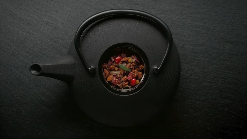

SL Mini - smoother, with plausible surface detail, but kind of dull looking and fairly blurry:
SL Sharp - even finer (while still being plausible) surface detail, but the green and reds go a bit overboard:
And here’s the actual 1080p encode:

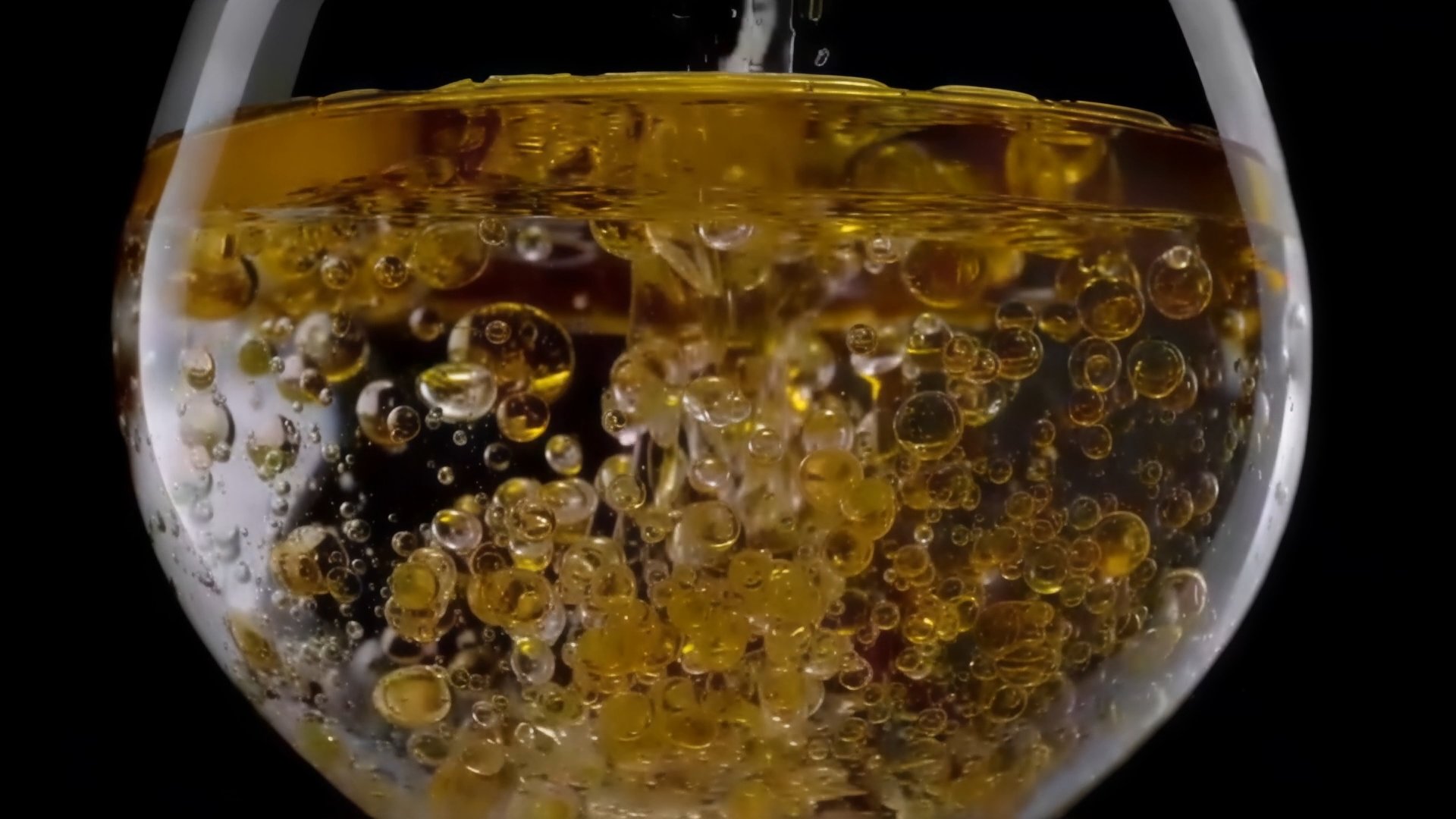

Here’s the original 360p:
SL Mini - smoothed over and duller, but did maintain pretty good consistency in motion:
SL Sharp - shockingly clear and usable a lot of the time, but it would break / “reset” occasionally (which was distracting) Also had a slight color shift:

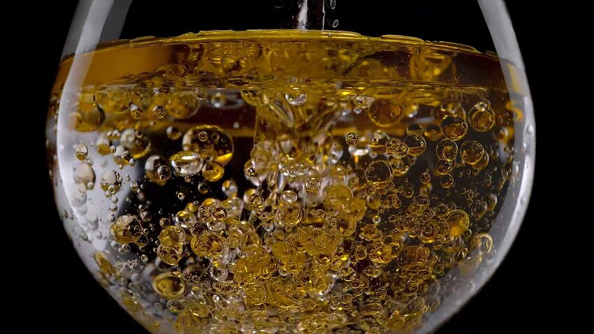

And the actual 1080p for reference:
