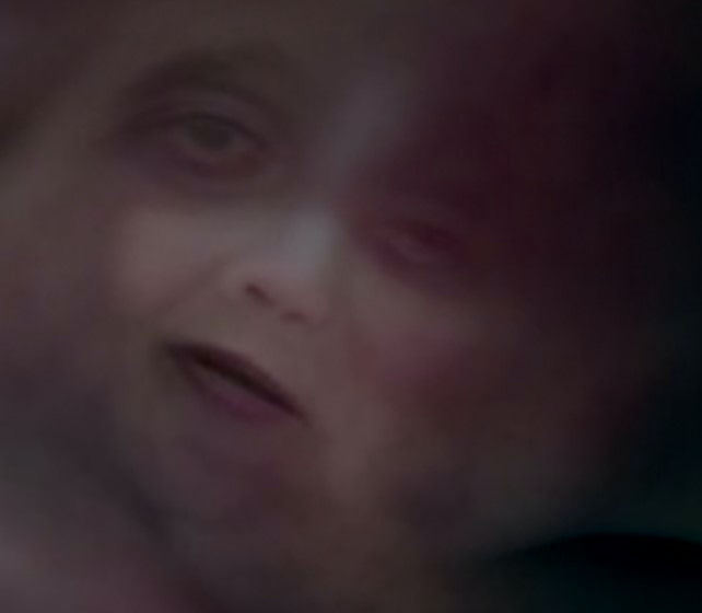

No I first use Rhea then do a second with Theia fine tune fidelity fix compression 15 and reduce noise 9 for old noisy vhs. I will now use after the rheia in first instance theia fine tune detail v3 Fix compression 50 percent and reduce noise 9 percent it looks promising. Ok these mocdels do not work properly to improve Rhea, Gaia Does not improve it either Nyx fast is terrible but NYXv3 is indeed supported to improve Rhea on top of Iris and protheus. I could use the slider to get more details, but I see that it only restores noise… so I now use RHea with Nyxv3 NXv3 is fast in preview but extremely slow when exporting a bug ? Back to square 1 Fine tune fidelity V4 Fix compression 11 sharpen 4 reduce noise 23 for my Rhea mp4 . This second enhancement makes Rhea is the best Square 1
apparently adding Theia as second does not work I have to import Rhea again then use ne tune fidelity V4 Fix compression 11 sharpen 4 reduce noise 23 to do get the best result Rhea has a bit to much noise for some ugly old VHS tapes while Rhea does much better on high grade VHS tapes that have not degraded to much. and is fine on Super VHS. So there are VHS and VHS quality differences every type needs it’s own enhancement profile difficult to choose one fits all
