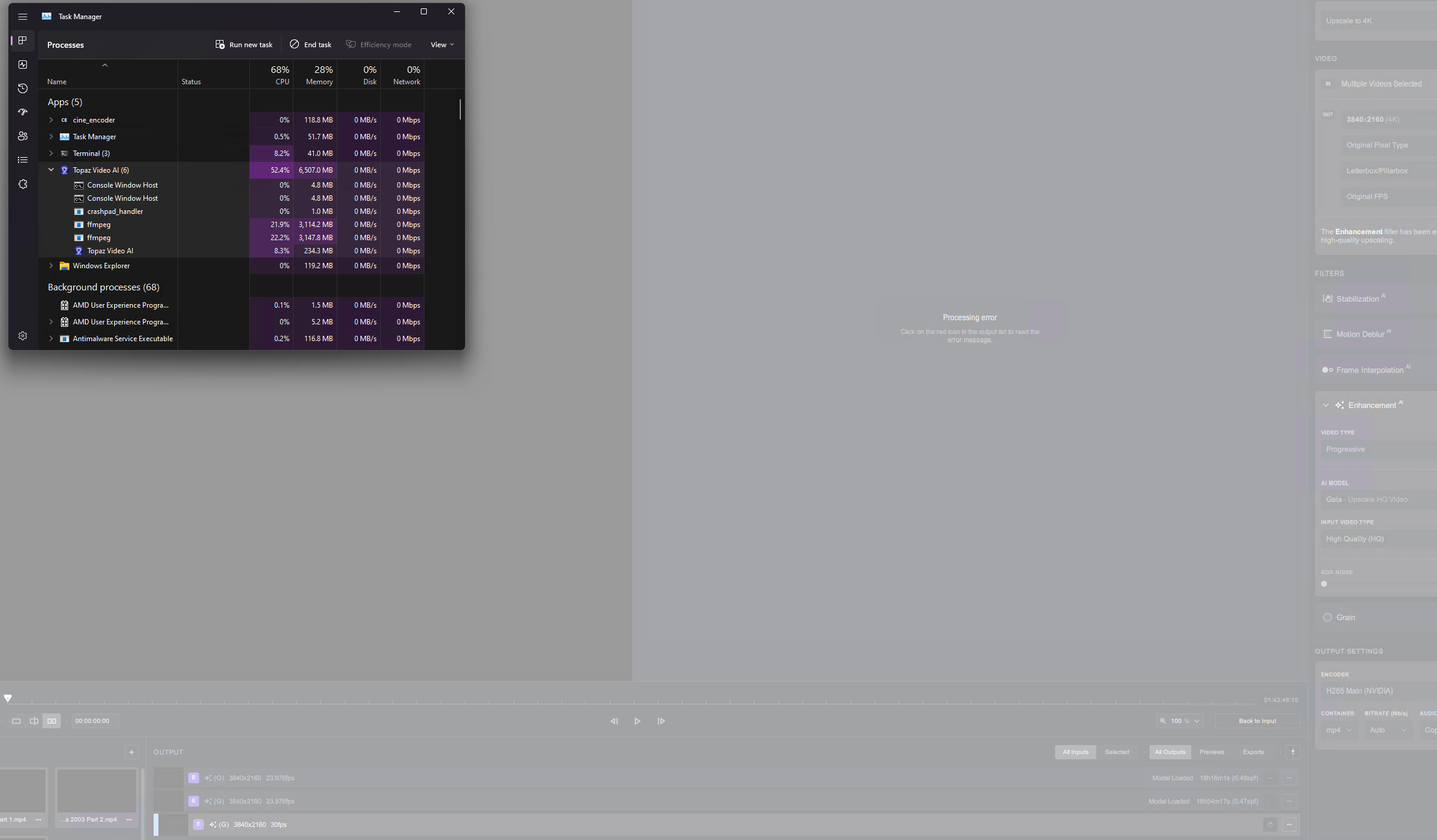

Trying this on Windows, I still seem to have the GUI lose contact with the ffmpeg processes. Windows reports that the tool has stopped responding. Task manager shows ffmpeg busy in the background, but there’s no GUI activity - it’s locked out entirely.
Not sure whether this is expected.
This is not expected, can you share the logs.

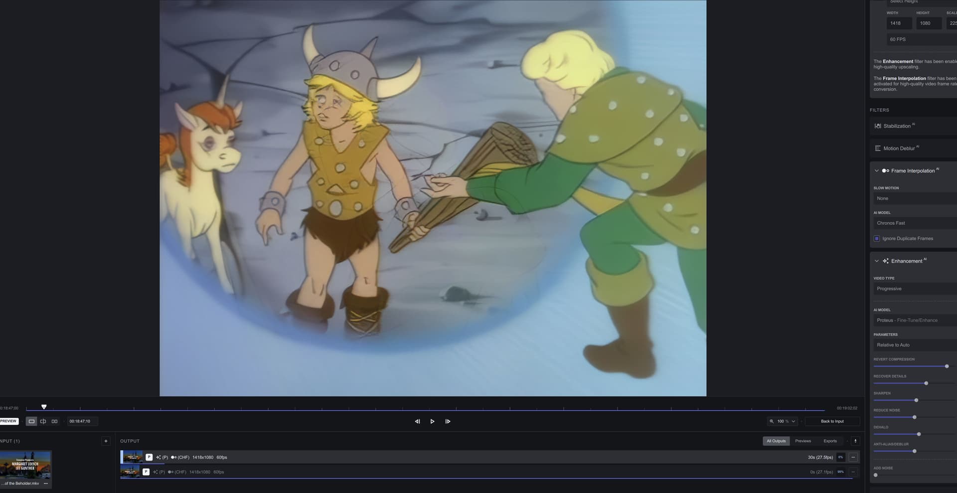

While I mentioned serious issues I have with this beta - it’s almost unusable, once I hit the “stall” wall - but last stable VEAI, v3.1.2 works totally fine for me (except that “I won’t add another same job to the queue!” bug, which occurs sometimes). :slightly_smiling_face:
With VEAI v3.1.2 I’m totally able to process D&D cartoon with Chronos Fast 29.97fps → 60fps and 480p → 1080p with semi-automatic Proteus.
This ZIP I’ll include is also an example of video with variable frame rate (it also has curios thing with non-square pixels), and this beta has trouble with it. This video has some interesting elements, like wooden floor, which can make frame interpolation algorithms cry. :slightly_smiling_face:

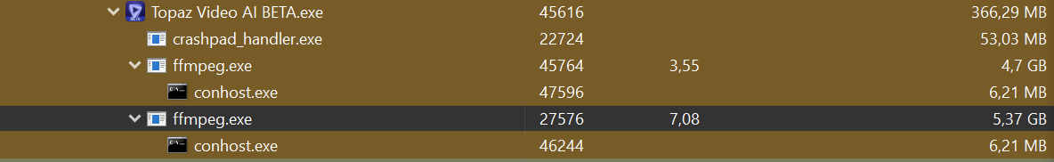

PS. During the “stalling” VEAI v3.1.3.0b “stalling”, the ffmpeg process occupy 100% of a single CPU thread (GPU mode). That’s on i9 7940X. Processing/previewing doesn’t continue.
It seems this beta stalls while scene change occurs (intermittently though). There’s even a preview on the processing list, which stalled just before the end (another scene cut, I believe). When I switched to the first one, this VEAI still shows the progress bar from the second processing:
With two stalled processings, the System Informer shows interesting thing - second instance of ffmpeg takes 2 full CPU threads:
