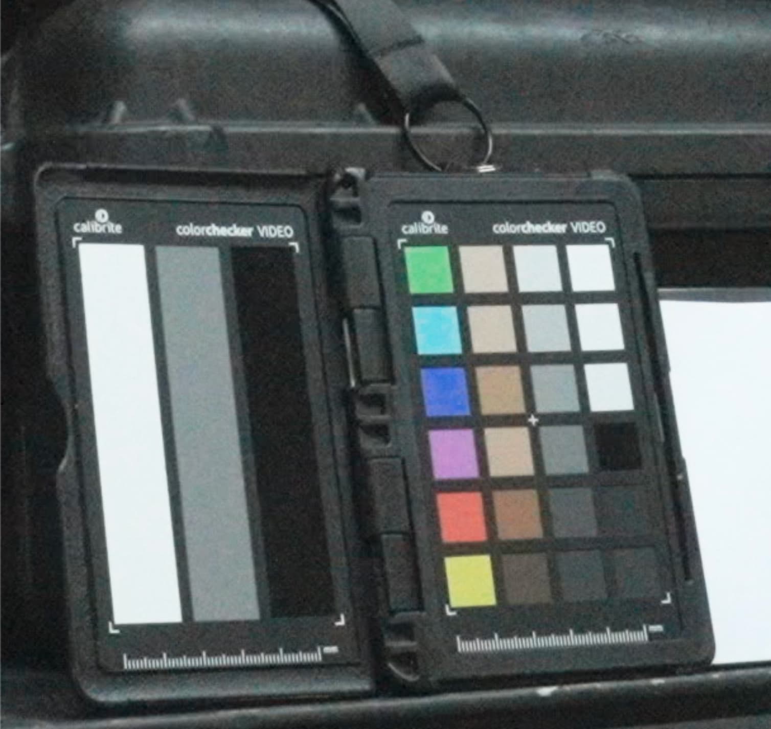

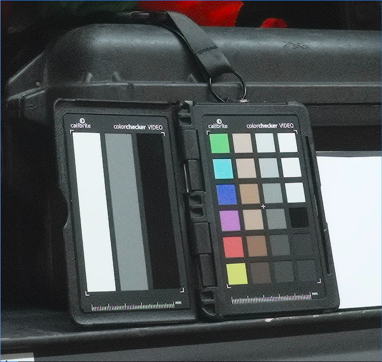

The image compares the result of Nyx 2 with that of Nyx 3. Nyx 2 sharpens by default and Nyx 3 does not, which is why the Nyx 3 result looks blurrier.
We can confirm that the sharpness of the input frame (attached below) is similar to that of the Nyx 3 result. Moreover, Nyx 3 (like Nyx Fast 1) enables the sharpen slider, allowing one to sharpen the result as needed (rather than sharpening by default, as in Nyx 2).

Thank you for posting a source image comparison. Nyx 3 looks much better, knowing how sharp the source was. The colors also appear to be closer to the source, than Nyx 2.

 was probably compared to the nyx v2 like in the screenshots :slight_smile:
