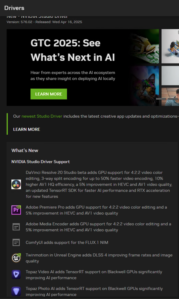

Video AI gets a mention in the latest NVIDIA driver update (4/16).
