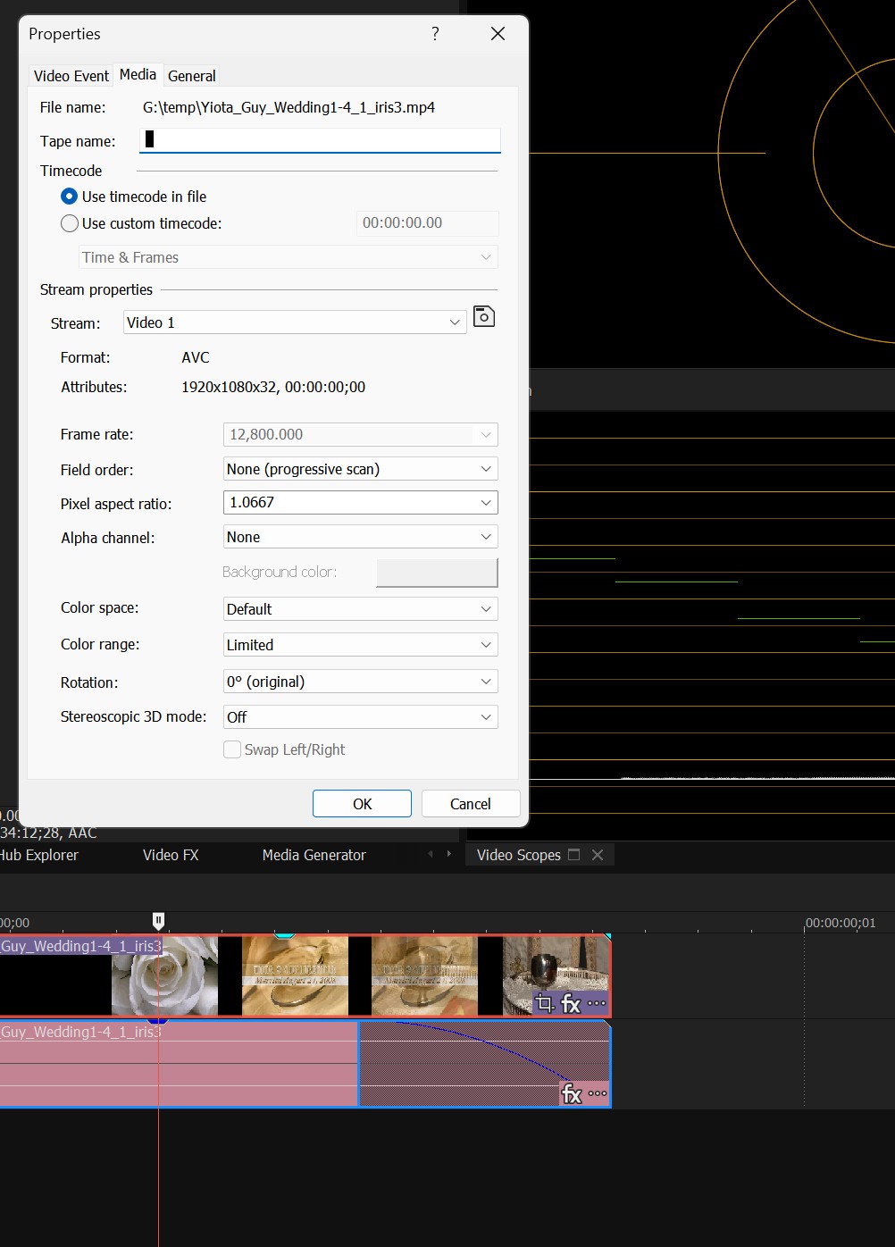

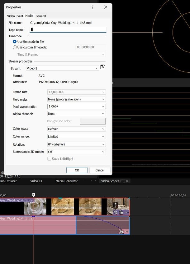

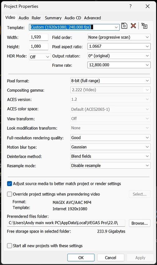

Topaz Video AI 6.2.2 2025 generated MP4 files fail to load into Vegas pro 22 (b250)

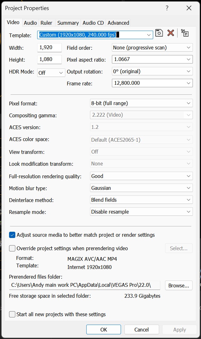

MP4 files generated by Topaz video AI fail to add correctly after importing into Vegas pro 22 build 250. It reads the frame rate as 12,800.000 and only adds a microscopic part of the start of the video to the timeline
Could it be that some metadata or frame rates are not specified in the created files?

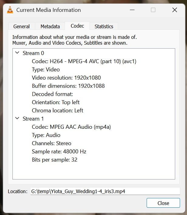

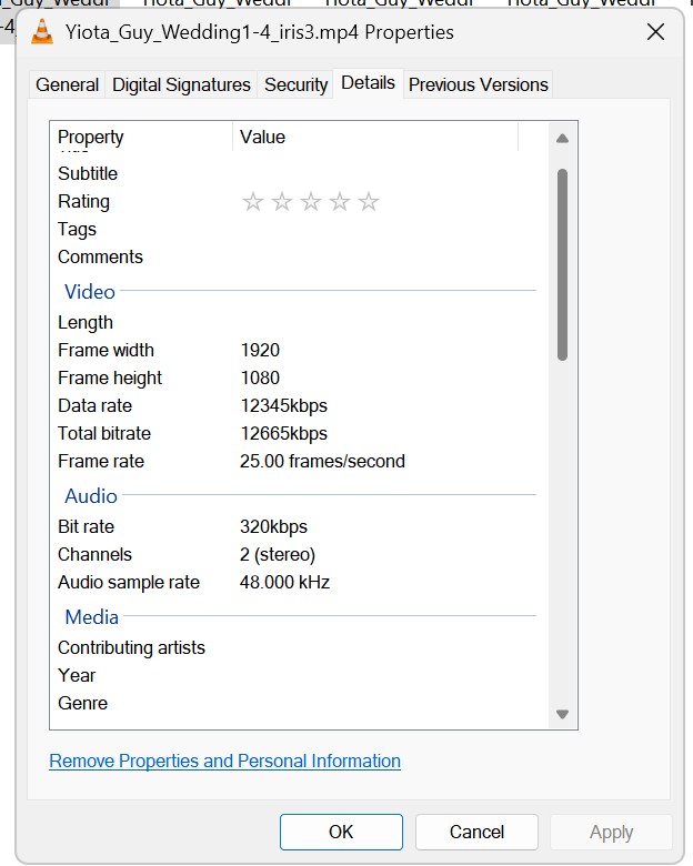

Looking at your screenshots you shared, it looks like the file is being shown as 25fps outside of Vegas, but 12,800 inside correct?

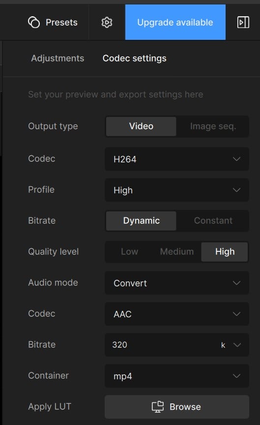

What were the export settings from Video AI? Looking through the logs I am not seeing the file referenced in the screenshots to check.
Thanks for as usual prompt response, appreciated.
yes the original AVI and exported fps are 25, when imported to vegas it shows astronomically strange import settings. Topaz VAI codec settings as per attachment, tried both H264 as well as H265
There were more users on the Vegas forum complaining about buggy Topaz VAI exports and suggested various intermediate conversions …
The exports also fail to play in various windows players apart from VLC this i did report previously I think. Each time I try to use VAI it gets very frustrating as the UI is changing and functionality of some parts is braking with each update, that’s why I rarely use it now and have stopped updating which is sad as it is a very good concept.

Tried both h264 and h265 xxx.mp4 sound=convert
I used ‘Copy’, which had always worked ok in previous tests. But it might be worth giving ‘Convert’ a try…
I usually use sound=copy but some cases the sound is MP3 or some other format so had to convert.
The rendered files play fine in VLC but not in any of the other 5 apps I usually have and not sure if it will play on smart TV’s and phones which makes the renders useless, for a very expensive program (same money gets you vegas pro a fully fledged video editing software) Topaz I find sadly very buggy
Just for the record, even though the thread has drifted away from the original topic, I would like to report that selecting Convert under Codec settings/Audio mode, rather than Save has corrected the problems I was having with various versions of Vegas Pro not recognizing audio in the MP4 files that Video AI was writing.
