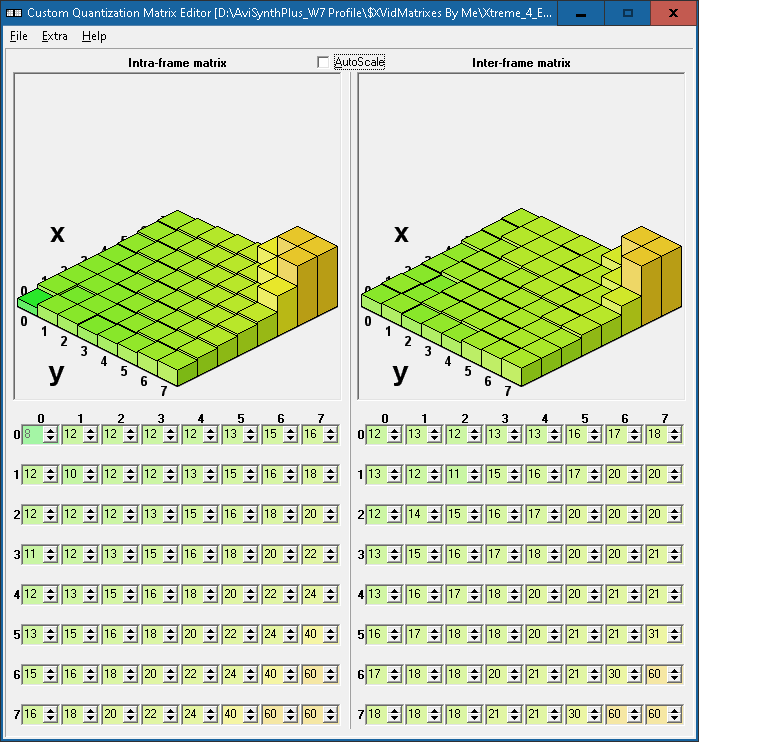

The Higher the Bitrate, the smaller the visual difference between lossy Codecs, until a Specific Resolution is reached.
Some Codecs need, less, more (surcharge ? what a strange Word) Bitrate to keep grain as other.
XVid needs less Bitrate “surcharge” (that’s how Google Translates the German Word “Aufschlag”) to keep Grain as x264.
Because XVid doesnt wash out stuff by nature like X264/h264 (XVid is dirty !)
Before H264 shows something “ugly” it deblocks and even if deblocking is disabled.
H264 will create always a smoother * looking Block (it has it reasons why x264 has all that Psy & and AQ Mode stuff ! AQ Mode makes the Picture more Dirty ! more XVid like. So that grain and fine Detail is kept better) as H263/XVid at the same Total Quantisizer and I Frame !
X264 need less Bitrate surcharge to keep grain, as H265 !
__* Now if we let out that H264 uses Cabac, BiDirectional BFrames etc etc
and just look at pure I Frame Output (so, no P,B Frames ! Nothing ! Pure I Frame Action !) and how H263/XVid, H264/X264 and H265/X265 threat Frequencys, then it’s clear that H264 & H265 both cheat !
They compress High Frequency Detail (example fine wood grain pattern, highly detailed skin section) stronger by nature ! (and if something with High Detail is compressed stronger, it’s not so obvious. Mid and Low Frequency suffer faster from higher Quantisizers)
So even if a “High Frequency” Block with Quanzisizer 2 is processed, it will look more flat (compared to XVid with Quantisizer 2) and will take less space.
That Space is used for Mid Frequenys, and Deblocking does the rest for Low Frequencys.
That’s why Gradients look smoother (no Trick, if fine pixels are eaten up) with x264, and Edges Cleaner, but the Form and Detail in Dark Areas can suffer.
H264 & 265 doesnt thread them as Important, because Dark Area ← People possibly dont look to that Area…But i do, especialy when the Main Action^^ is there.
XVid can cheat to !
