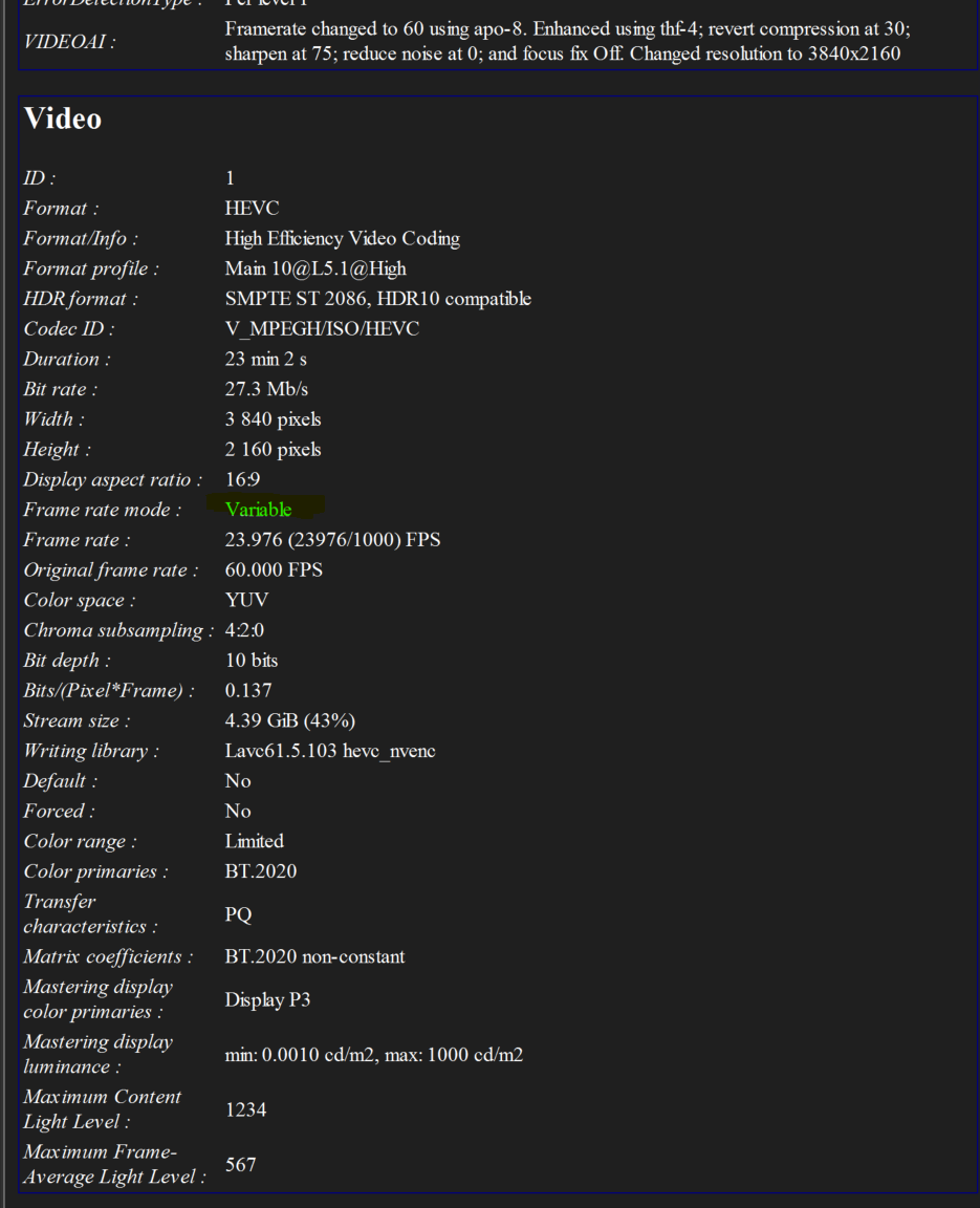

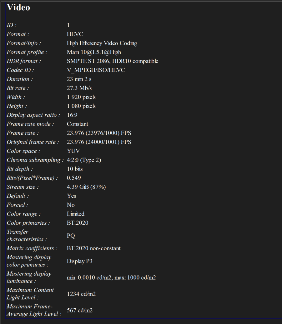

I’m getting variable output with frame interpolation to 60fps (from constant 23.976fps)
Input is MKV (1080p HEVC HDR10 P3 (with an AC3 audio track))
Output is MKV (H265 main10, constant 60mbps bitrate, passthrough AC3 audio)
Only MP4 output shows “constant” for my clips, however it is NOT constant 60fps.
When averaging the amount of frames over time of the clip, results vary from 56 to 59.94fps average, so the mediainfo is flat out wrong. I have not checked min or max frames.
The metadata for MKV could use some work. light levels are incomplete and the “original” frame rate 23.976 should be removed, to be more consistent with MP4 metadata.

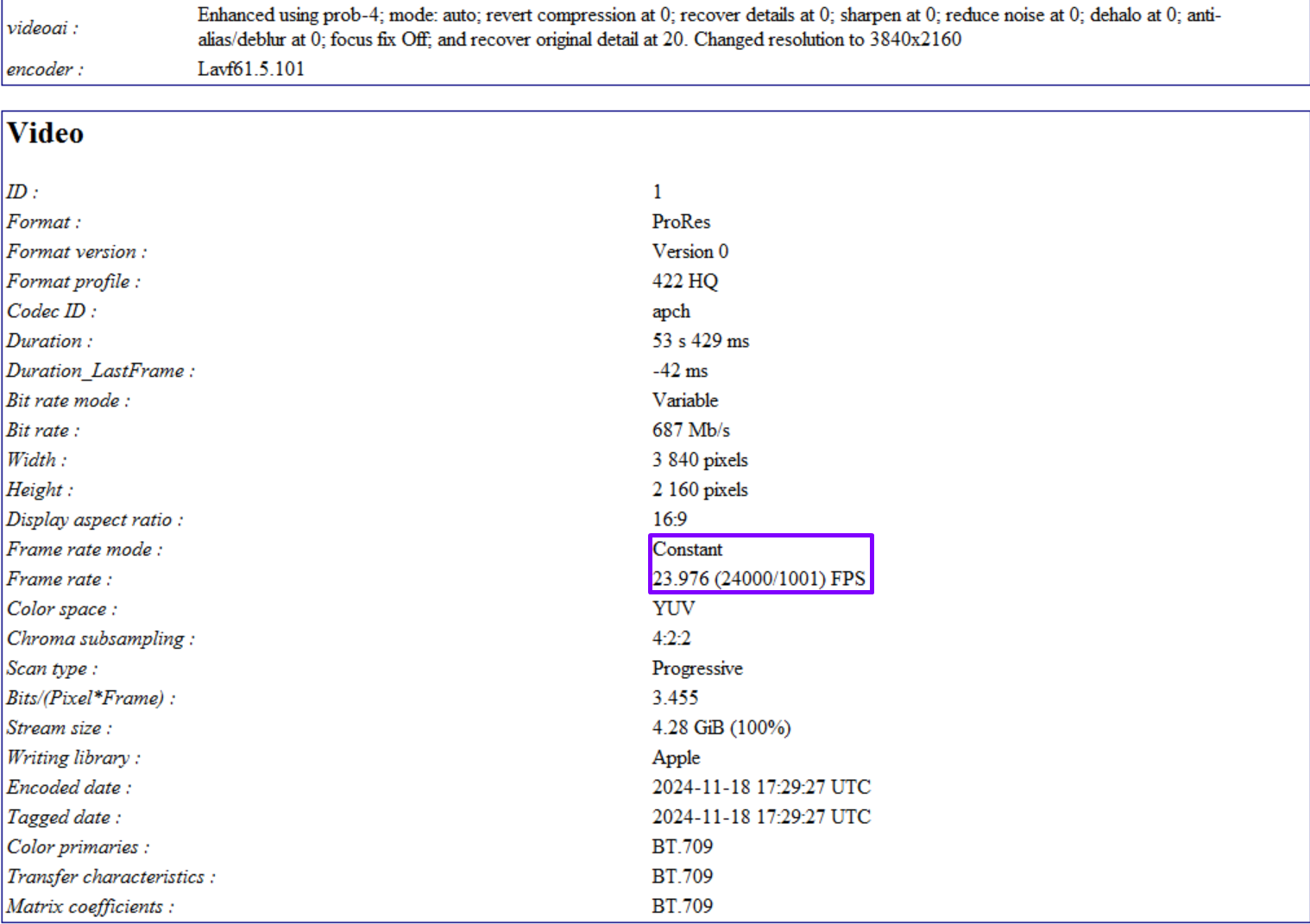

Okay, that is exceedingly weird. For the record, I output to FFV1 (with a .mov extension, else LibavSMASHSource won’t open it). I will try and output to true ProRes 422 HQ now.
No, it was already set to ProRes 422 HQ by default in the new beta.
Thanks for looking at this. For me, and others, apparently, this VFR bug is most egregious.
EDIT: I had tested it on v6.0.0.0b, btw.

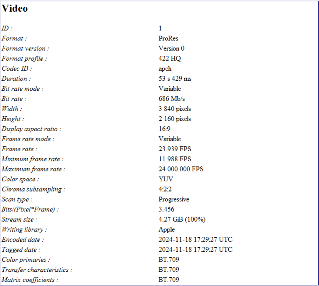

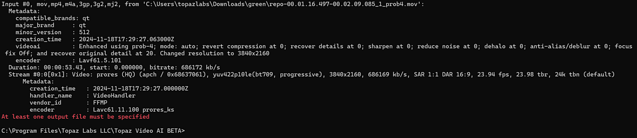

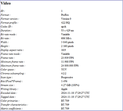

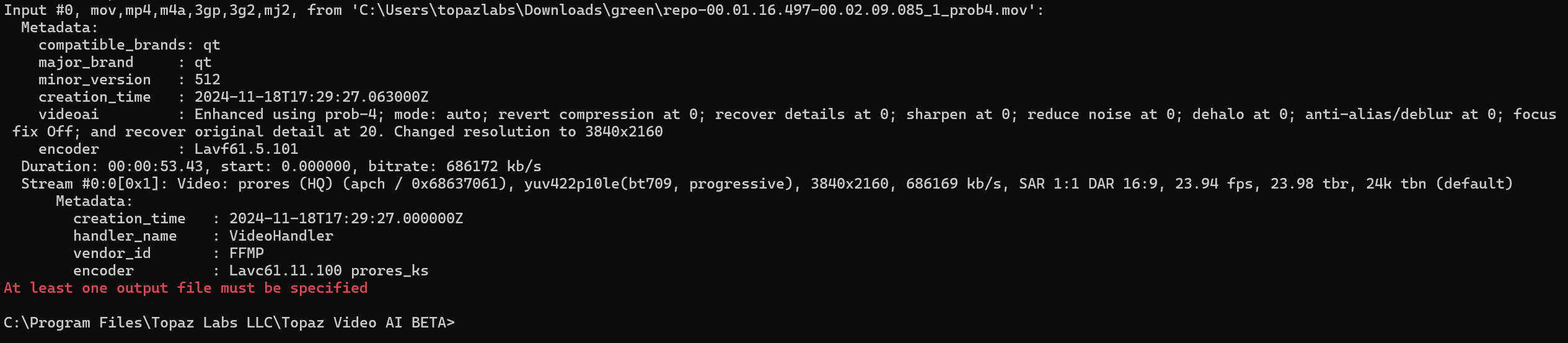

Interesting, MediaInfo reports the _prob4.mov version you sent over as a ProRes 422 HQ(?)
Same with ffmpeg:
Yes, my bad (see above). Apparently, beta already defaults to ProRes. Doing the opposite now, trying FFV1 instead. :slight_smile:
WAIT, that may have been it (Sic!) FFV1 reports a CFR output!
